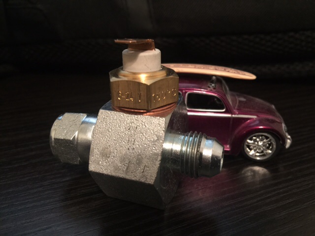

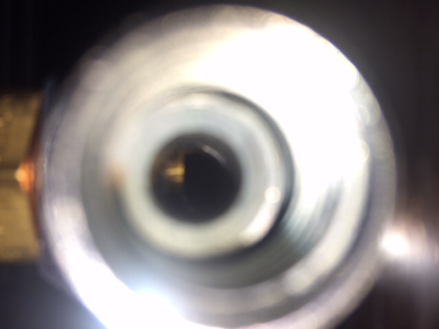

Got the -6AN last night.
 Post subject: Re: Oil Temp.
PostPosted: Sat Nov 22, 2014 2:33 pm
Thats a nice piece. Why are you using 6 AN, usually one would run 8 for oil lines?
PostPosted: Sat Nov 22, 2014 2:52 pm
I don't know why but the oil filter kits come with 6AN.
