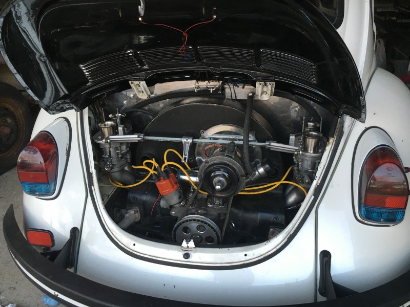

Ok so I have power at the coil and I used an inductive pick up to determine there's power through three plug wires. Turns over but never seems to fire. Carbs have gas and accel pumps are working. I checked the points gap and it's good. What should I check next?

PostPosted: Mon Jan 18, 2016 5:58 pm
11 volts across the coil with the ignition on

PostPosted: Mon Jan 18, 2016 7:09 pm
Just the carbs. I cleaned them and reset them to the basic starting point

PostPosted: Mon Jan 18, 2016 7:15 pm
Timing hasn't changed. Haven't moved the dist. I can see gas squirt in the carbs. The inductive pickup from the timing light picks up power in all the wires, EXCEPT number one wire...

PostPosted: Mon Jan 18, 2016 10:34 pm
Yup. Miguel came over and we tried that. Seemed to help a little but still no catch. We tried his coil and condensor that we knew were good. Same thing, just cranked and cranked. New rotor and new cap too.
