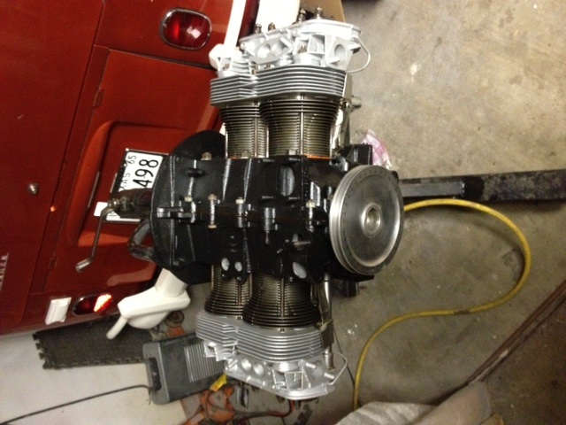

Finally got the long block built been busy

Looks fantastic! Should be a nice little motor

Good work bro.

Thanks Iam going try to get more bolt on put back on tonight
