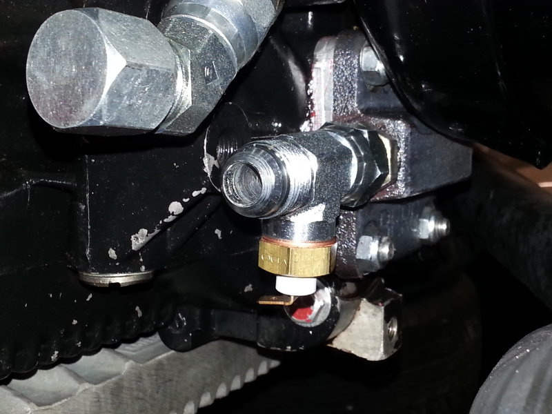

I decide to go with this. It look much easy to install it and don't want to mess with case.. :roll:
http://www.thesamba.com/vw/forum/viewtopic.php?t=534617

hmm that is interesting, you will be getting the temp before it makes it to the cooler or filter, wonder how that plays into the theory of which is the best spot.

Kostya showed me that a while back.. I thought it seemed like a sound idea.. fresh off the bottom of the case oil temp..
I dig it... RJ you are doing a great job i think putting your car together :thumbs:

wouldn't the sump cover sensor give the most accurate?

That's pretty cool, hadn't seen that one before. I guess you can argue about what location is "most accurate," but at the end of the day, where ever you end up locating it, you just need to know where your car normally runs, then just keep an eye out for deviations from that that may spell trouble. :thumbs:
I can say that where mine is though, it corresponds pretty good to when my 180-degree fan thermostat kicks on, so I believe it to be fairly meaningful in absolute terms. I don't think I've ever seen over about 190 degrees in my car, if anything it runs too cool. Cylider head temp (maesured on #3 plug) usually runs around 275-290 degrees. Whoever said big motors run hot was full of hot air :P

Here the guy make one and I order from him. tired of looking around for fitting.
http://www.thesamba.com/vw/classifieds/ ... e=Hotrodvw
