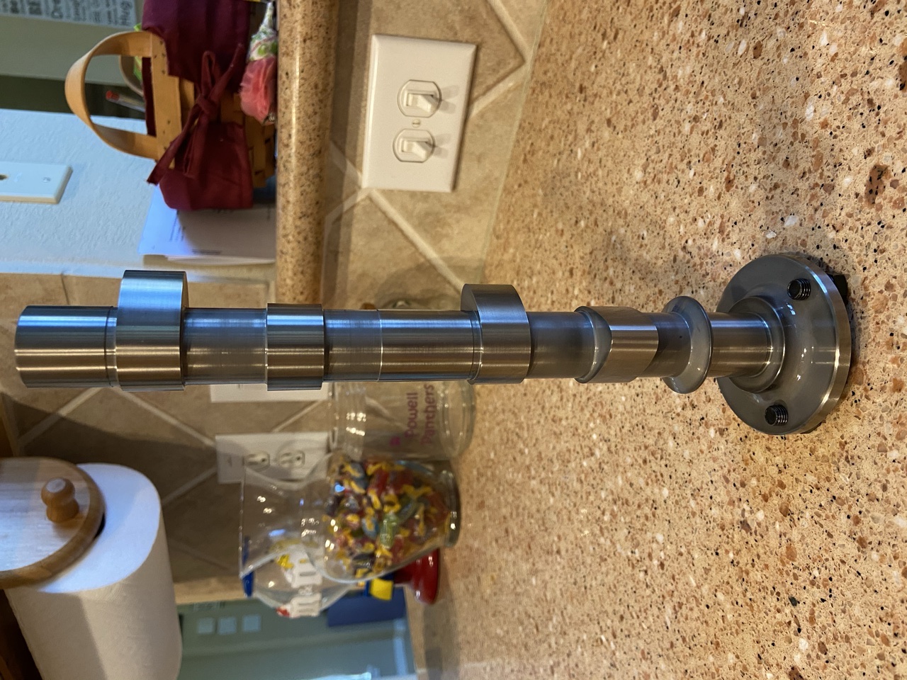

Ethan:
I recommend looking into Jurgen Nowak cams. CNC steel billet cams with the highest level of accuracy. I just put one in my Super Squish piston engine and it is awesome. Valve to piston clearance is bitch with these pistons due to their shape
I can email you his cam selection spreadsheet if wanted. Another key thing is that most of the 1.4 rockers actually measure out to 1.45 to 1.5
Also recommend CB Performance’s full length pickup tube...no welding needed
