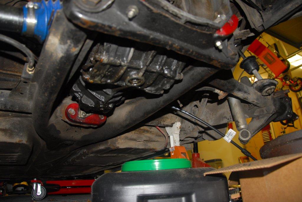

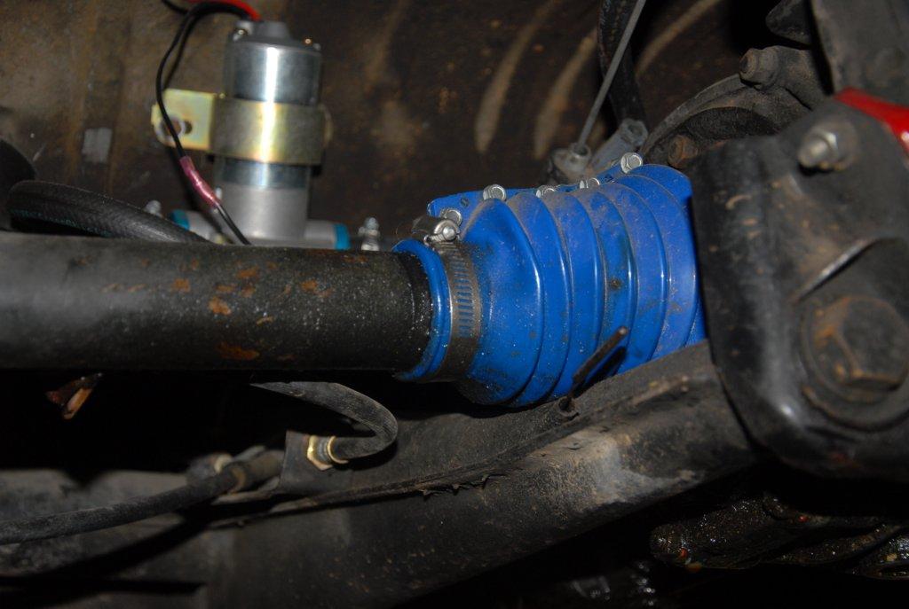

Background. I bought a 1968 Bug (my first bug), its a bit rough but complete except for a motor. I bought a 1835cc dual port motor from GEX but I haven't yet installed it. I've been rebuilding the brakes and axle seals etc. I'm getting closer to installing this motor and now I'm looking closer at my existing transaxle. I might be easier to identify the areas that are not leaking rather than the many areas that are. What would be the process to rebuild this? Is it easier to just buy a new one? I hate to waste a bunch of time installing the new motor only to find out the transaxle has issues beyond the obvious leaks. Does anyone in Houston rebuild these? I see lots of new or rebuild units on the internet but what should I look for? Any advice?

You call that a leak??????? :lol:
Clean it up and see if you can tell where the leak is from. It may just be from the boots. Installing and removing the engine are very easy jobs so dont be afraid of taking it back out if the trans is shot, well worth the gamble over just putting a new one in.

Every now and then a used working swing axle trans will come up for sale. There are a couple of guys around Houston that will probably rebuild one for you. I'm with Ryan, clean it up, fill it up with gear oil and see if you can find where its leaking from. I would change out the rubber boots with good german ones. The chinese ones can leak (from my own experience). Also, I've read about those red trans mounts that you have. Some guys have bad experiences with them, I've never used them. Study up on them, that way if you pull the trans you can replace them.
Again, like Ryan said, pulling the engine and trans isn't that difficult. I'm sure if you post up a date for a work day a couple guys might be willing to help.

First thing I noticed in your pictures is that the axle boot is installed incorrectly, that could be one of your leaks right there. While you have the motor out it is very simple to remove the tranny and re-seal it. If you are unfamiliar with the process, take it out clean it up and bring it over to my house and I will show you how to re-seal it, It is a simple process. Also I am with Bo ditch the red mounts.

I ran some OE quality boots.. with very little luck.. I am not a fan of everything empi.. but apparently they are widely known for CV and axle boots for other cars also...??? I used a set of their boots and have not an issue with them since.. I was told
some of the stuff in some transmission fluid will eat the rubber pretty bad.. that is what happened to mine..
