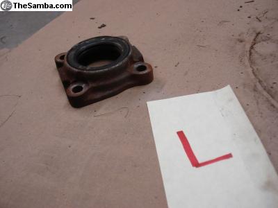

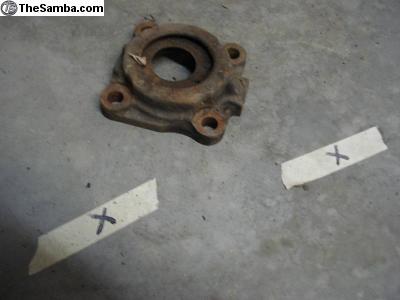

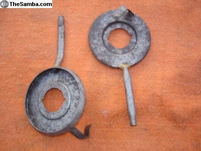

thats good that the weep hole is there, that means that someone at least either drilled the hole or they swaped backing plates when they swaped the end cap. see a 58 should not have the weep hole it should have oil slingers in the hub. when you take the end cap off make sure that the drain in the end cap is not plugged up. I like to use black rtv when i put them on.
File comment: and these should be in your hub when you have the right end cap. what you have will work though.

File comment: you should have this end cap. notice the larger hole where the seal goes. and it does not have an oil deflector washer.

File comment: See you have this end cap that that has a oil deflector washer
