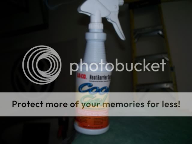

Yup,, there's one called cool gel that works good too. It comes in a spray form, but doesnt run at all. It sticks where you spray it, and needs little to no clean up, washes off with a damp rag.

This is the stuff. made by La-Co. Not cheap, about $20. worked well though. I like the easy cleanup
Any welding supply should have it. I could send you a bottle if needs be, just lemme know
