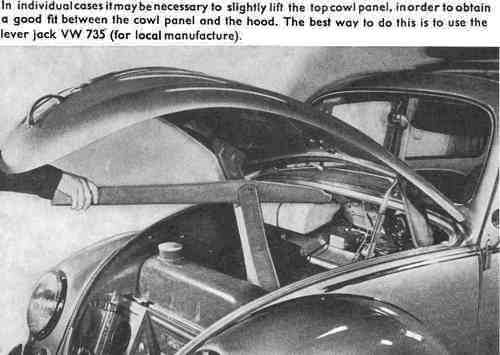

a little hood action
That jack is crazy :shock: :shock: I've going to run home and try it on Tootsie Roll :hillbilly: :hillbilly:
