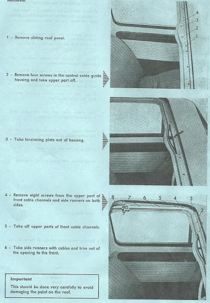

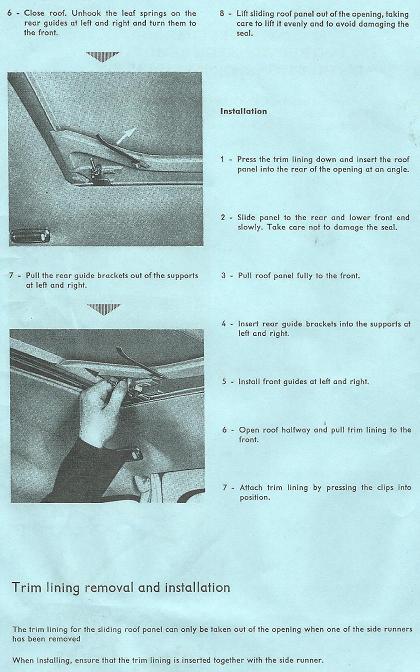

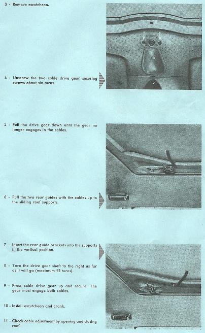

PostPosted: Sat Sep 24, 2011 7:57 am
instructions

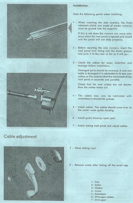

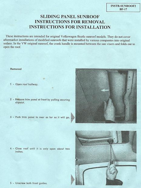

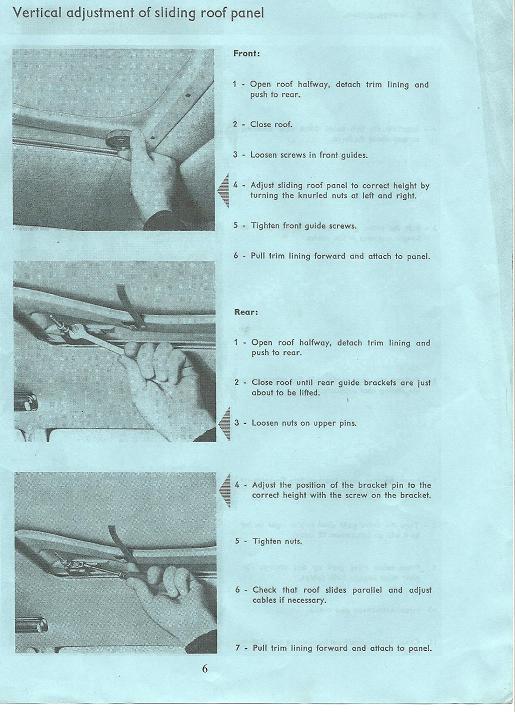

 Post subject: Re: metal sunroof instructions
PostPosted: Sat Sep 24, 2011 8:10 am
more
