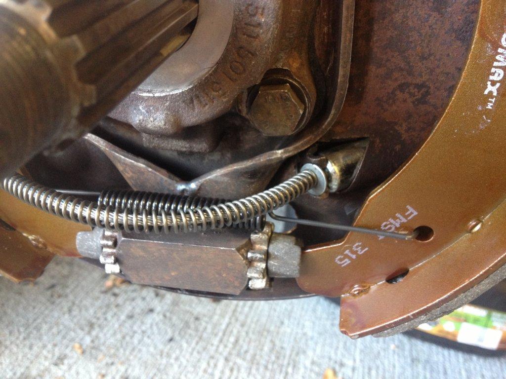

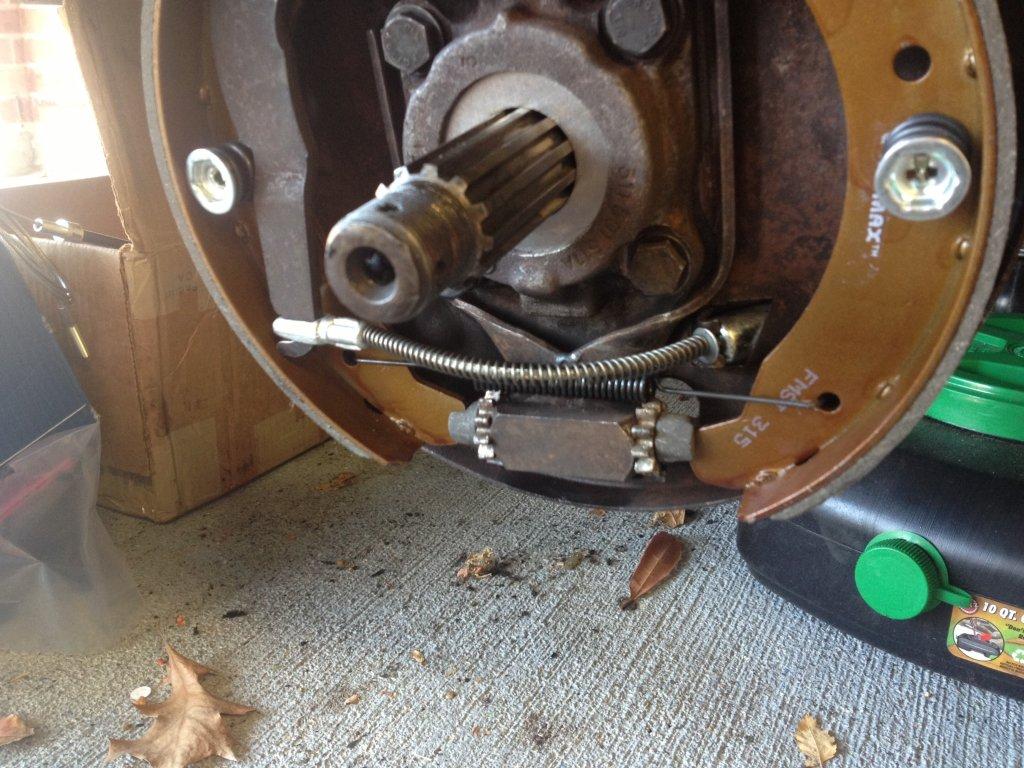

The cable did come out with some tugging and pulling. It was frayed and I guess it snagged on something. New one slid right in. How much slack should there be in the cable? (See my photos) Seems like alot but maybe I shouldn't judge that until the brakes are bled and adjusted. I compared the new cable vs. the old one and the length was identical. Another question. How hard is it to put on my new drum? I tired to slip it on and it didn't want to go. I also tied the old drum and it was difficult too. Maybe it needs a little force to go back on? The kids had to go ride the Polar Express train and see Santa so it was a short day in the garage. Maybe more time tomorrow???....probably not.

Looking at the last photo you posted, looks like the pads aren't "seated" all the way (bottom right). Are they new pads? If so, you'll have to play with the adjustment some.

Also make sure the adjusters (your bottom pic) where they match up to the shoe are at the correct angle. You may also need to be sure the brakes as a unit are centered, equal space all around.

Yes. All new brake cylinder, shoes, hardware, etc. I realized the adjuster screws were tapered so I think that's right. It all seems like it's got alot of slop. I assume that will tighten up as I get everything adjusted.
What's that general procedure? Get it all centered up best as possible. Put on the drum. Adjust the adjuster screws just short of the shoes dragging. Then bleed? I haven't read through the procedure yet.
