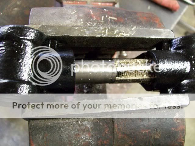

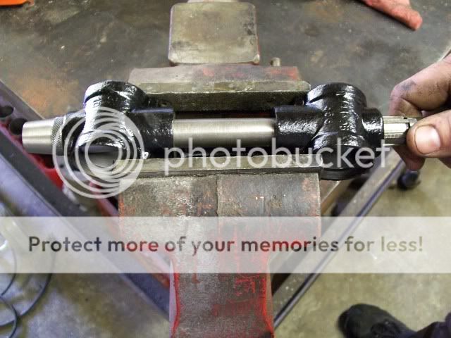

several of you have asked me how i rebuild the king pins,here you go
the old bushings are driven out with a driver and the new ones are driven in.the reamer is set to .005 smaller than the king pin size,the alingment cone is set at the opposite end and the reamer is sent through
reamer taking out excess material

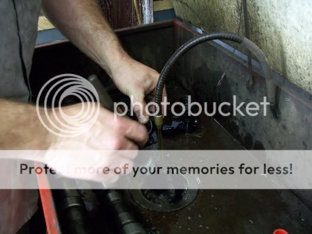

using a sunnen power hone the bushings are honed to the king pin size
the knuckles are cleaned in the vat to remove the honing oil and to check final fit
final fit,ready for grease and assembly
