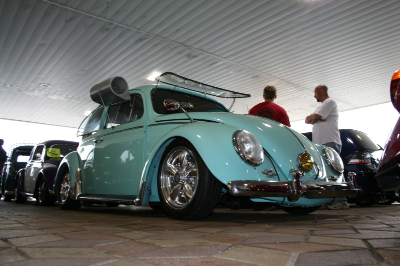

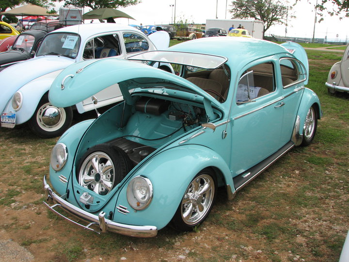

62, 4" beam, drop spindles, 5.5" spokes, smart car tires= NO RUB AT ALL!
I am also running those ULTRA COOL drop plates in the back that give you a awesome factor of X10 and 5 more HP. :P
23788_1366743602262_1041826573_31061695_1395952_n.jpg [ 124.36 KiB | Viewed 6480 times ]
