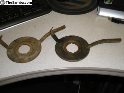

63 shouldnt have an oil slinger washer. somebody must have switched end caps on you over the yrs. it should have the oil slingers in the hub. like these
you will need to make sure your backing plate is drilled
edit.... or is that a pic of the actual oil slinger that has been spun on the axel?

It may be that you are missing the oil slingers like i posted, if you could shoot me a pic of your end cap i could tell better what you have. If your hubs are not drilled for the slinger then who ever owned it last may not have put the slingers in when they replaced the hubs. (this is very common)
