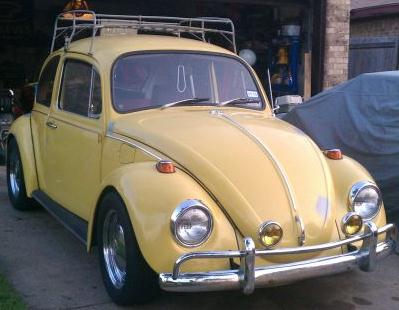

Just purchased my first vw. It's a 1968 bug. It's complete and soild except for an engine. I know there are books and enless articles on this but can anyone give me a concise (and quick) primer on engines? I'm confussed. I see lots of engine displacements & lots of options, etc. I'm going to want a reliable, steetable motor, fairly quick acceleration, highway cruiser. Where am I going to find a motor? Some local vendors have options. The internet is full of them, vw catalog vendors have them all over too and the prices seem to vary greatly. I also see some motors for sale by indivduals but some of those deals look bit scary not kowning what you're going to get. Do I look for a long block and build the rest? Do I look for complete motor? Do I build a complete motor from scratch? Do I find an old motor to rebuild? I know the answers to these all have cost implications but what is a reasonable amount to spend? I'm not adversed to maybe finding a motor to get my bug running and on the road knowing it might not be the final motor I use but I also don't want to waste a bunch of money redoing somthing down the road if I don't have to. If I could find the right set up now I'm sure I'd be ahead down the road. Any thoughts would be appreciated.
