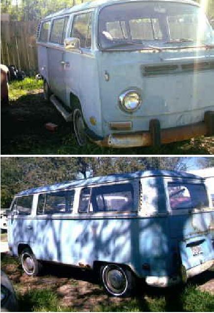

I have a question, how do i remove the fuel tank on my 1971 vw bus to put a new one in?
