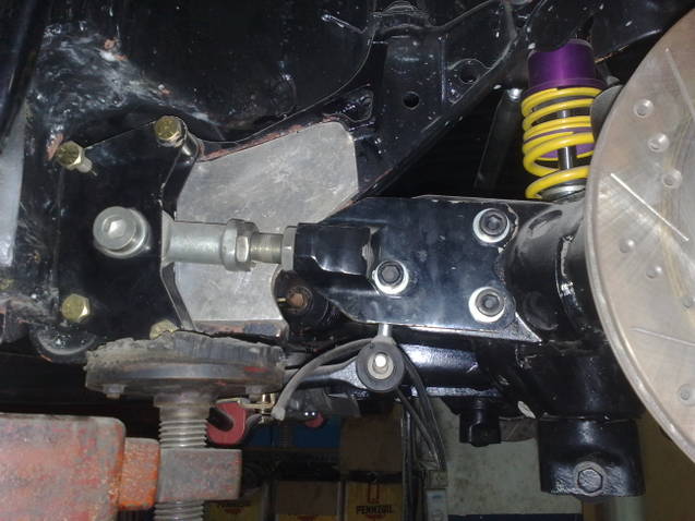

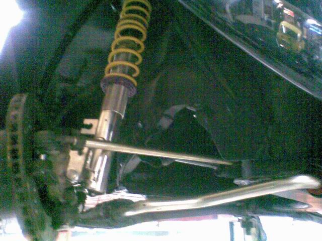

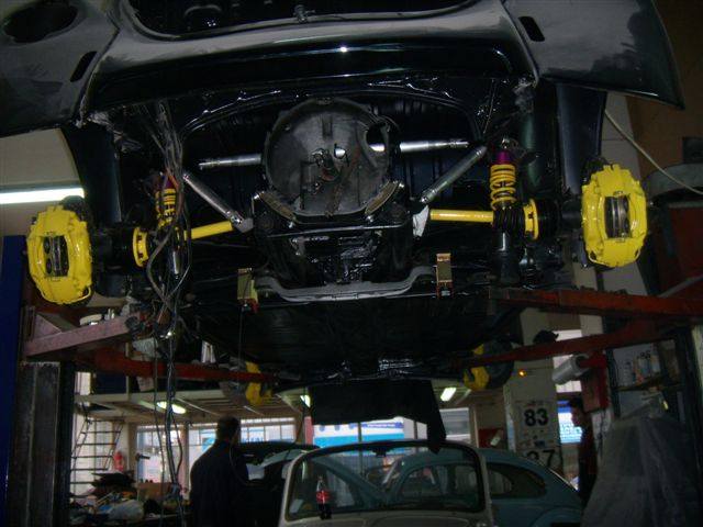

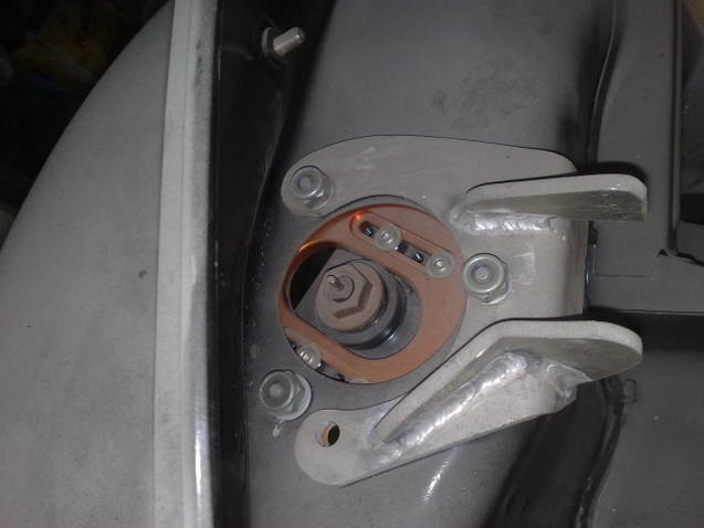

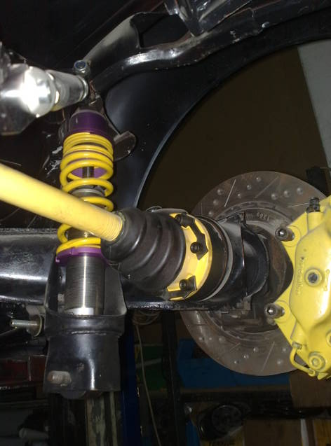

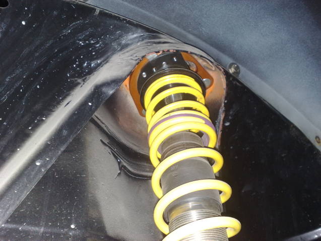

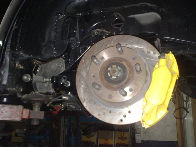

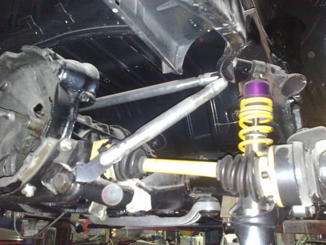

Then we moved to the suspension. The car has a rack and pinion steering wheel which for this "track oriented" cars are really important, therefore having that as a basis we placed a serious suspension, big Porsche brakes and of course a uniball rear set up with lots of other small tricks in order to be able to fine tune the suspension depending the track, etc.
Suspension
KW variant inox line coilovers all around - http://cs-beetle.com/ & http://www.feinecabrio.de
Front adjustable top mounts - http://cs-beetle.com/
GWD rear uni ball system - http://www.gwd-weiser.de/
PORSCHE 944 turbo suspension arms - http://cs-beetle.com/
VW 1303 super beetle front lower arms - http://cs-beetle.com/
BILSTEIN steering damper - http://cs-beetle.com/
KERSCHER aluminium front + back anti roll bar - http://www.kerscher-tuning.de
Aluminium Cub brace / torque bar - http://www.kerscher-tuning.de
Aluminium Front strut brace - http://cs-beetle.com/
PORSCHE 996 gt2 6 pot front brakes with new discs - http://www.v-zweeden.com/
PORSCHE 964 Carrera 4 - 4 pot rear brakes with new discs - http://www.v-zweeden.com/

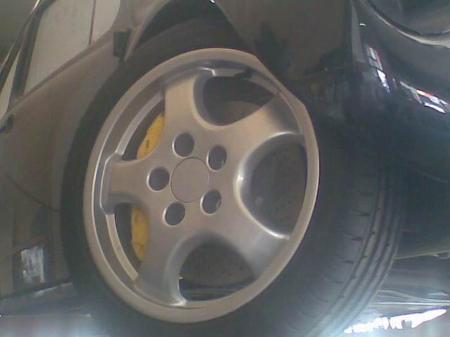

Wheels & tyres
PORSCHE 911 Cup I - 7,5 x 17 "dressed" with brand new Continental tires - http://cs-beetle.com/

a few more!!!

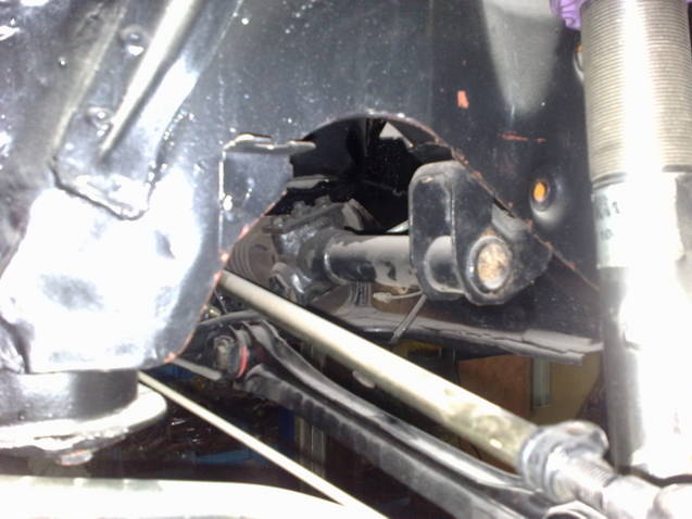

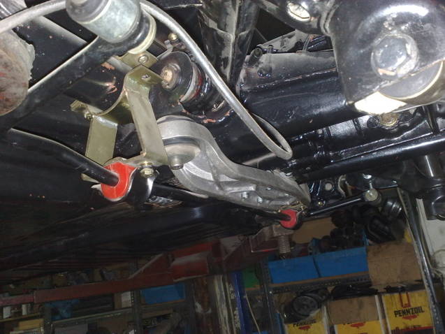

and a few more of the suspension
