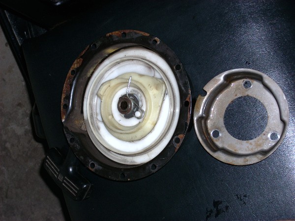

Starting up the T'NT after spring/summer/fall lay-up is always an adventure; lots of pull-rope swearing and sweating.

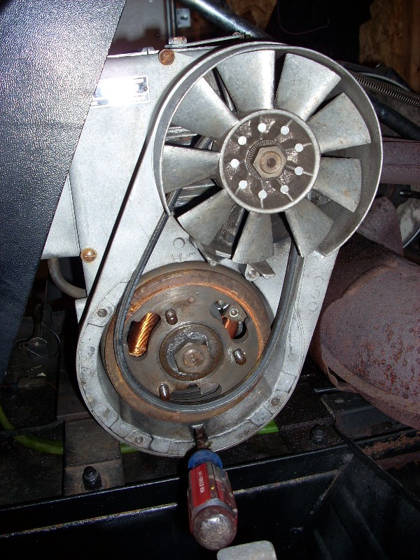

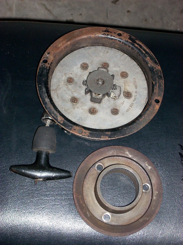

The Craigs list guy I bought the 400 motor from put on some unknown late model recoil starter. It's about 80 percent plastic and thus works about 20 percent of the time - if that. The plastic foot is meant to grab the recessed grooves inside the pulley. However, being plastic, it no longer catches but slips over the metal grooves.
I unbolted the recoiler off my 340 motor, and even though a few grooves are worn on the pulley, it turns the motor over each yank.
File comment: Good thing VW's aren't pull-start

File comment: 340 pulley: built to last metal

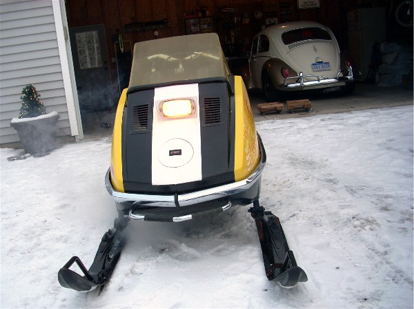

The metal pulley works, which is good because I pulled ... and pulled ... and pulled but no go. After spark check, fuel, turn key on (I've done that before :oops: ) I finally resorted to shot or two of starting fluid. Few pops but no go.
Pull start and gravity-fed fuel can give your arm a work-out. I was just about ready to shove the sled back in the garage and head off to work when it turned over and died. After a few more pulls she roared back to life after the last ride in March.
The weather forecast is for about 8 inches of snow over the next day or so. I'll post some riding photos (maybe a video).

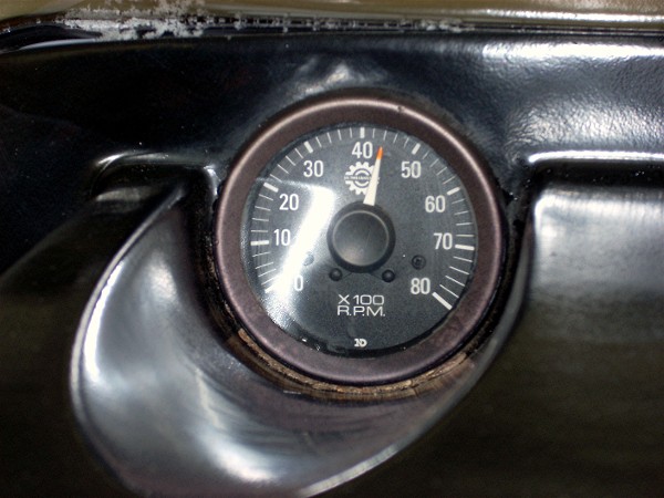

File comment: 4,000 grand on 8,000 grand tach - that's about 1/4 throttle. However there isn't much left after 3/4 throttle
