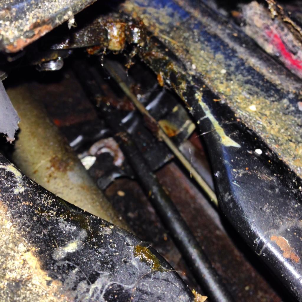

I replaced the pedal cluster with a rebuilt one with all new bronze (instead of plastic) bushings. Seat out, carpet out, dove into the tunnel and replaced the accelerator rod bushings, and the rubber coupler piece. I really wish Porsche used cable instead of rod for the accelerator, but they dont, and there isnt any kind of retro kit.
