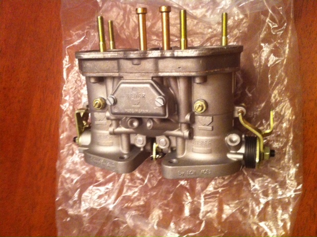

The_Half_Bus wrote:
And so it has begun
Super excited about this... Here is the list of parts (so far) for the Double Cab engine build:
2110cc
Aluminum bubble top case
CB 82mm crank
AA 90.5 pistons
Unitec I-beam Rods
Stock heads
CB cheater cam (2280) Adv. 274 Dur. 222 Lift 359
CB Big foot lifters
Swivel Feet Rockers
Weber 40 IDFs
CB Dual Carburetor hex linkage
Empi Welded/balanced fan
Empi Alternator Kit
Empi Oil Breather Kit
Gene Berg External Oil Filter
Scat 36hp doghouse shroud kit (Will be powder coated white, figured that would look nice in a rusty white Double Cab)
Lightened flywheel
Bottom end dynamically balanced by Lyle Cherry
Trying to decide on exhaust.
Really glad I met Tommie :thumbs:
Decided and ordered an exhaust..... A1 sidewinder black ceramic. :argue:

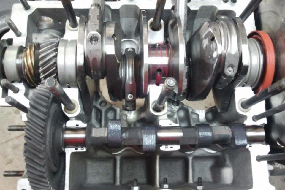

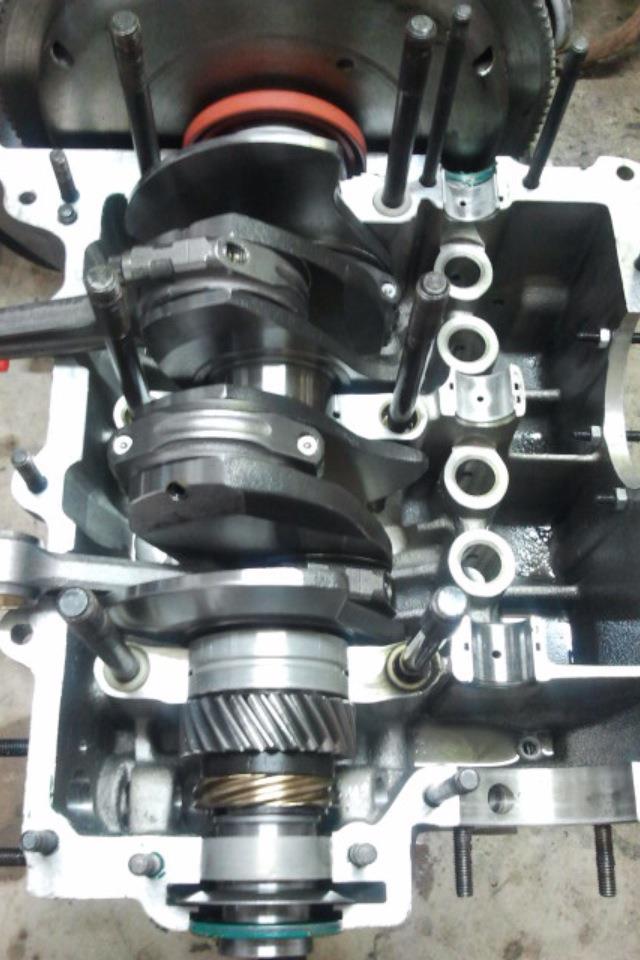

hmmmmmm......
