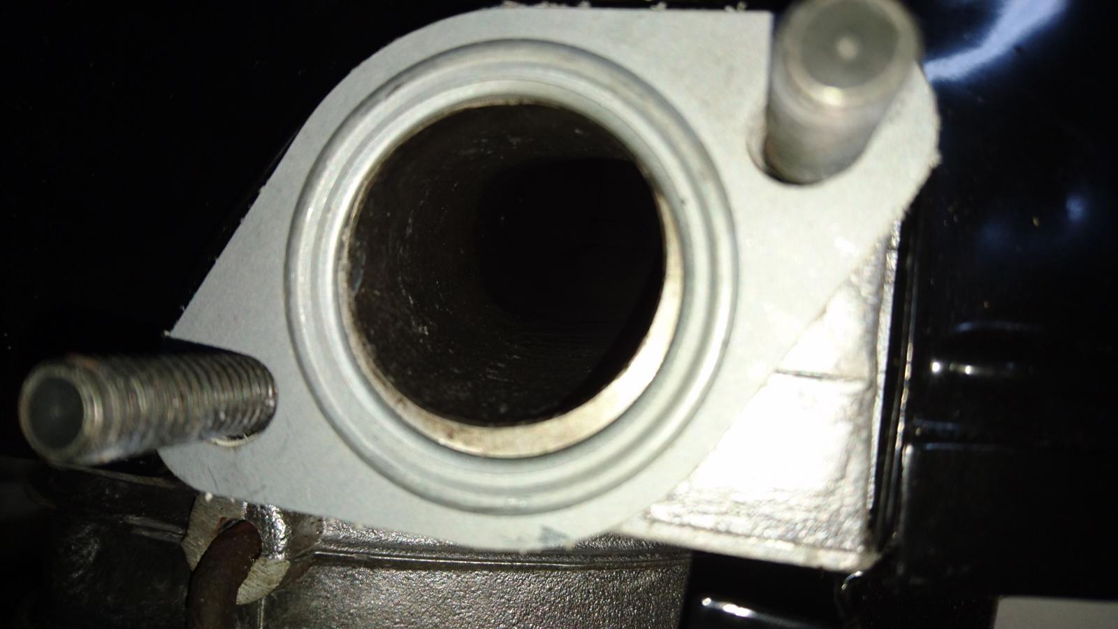

I should have been clearer, you are correct that the port needs to step down from the exhaust flange to the valve, but the port still needs to be opened up for the increased performance and matching up with the selected exhaust. Not to mention fixing the casting error
I'll post some pictures of what I'm talking about
Unfortunately the guy who built the engine will not share the details, but the work was insane.
Probably close to $15k...it's for a special Porsche Landspeed project

WW Okrasa head exhaust port issue below
Will it work...yeah, can it be made better, yes
 Post subject: Re: 36hp clown college engine build
PostPosted: Wed Aug 02, 2017 8:39 pm
Wow, oops, lol. I guess no one told them the port should be centered on the studs. :P

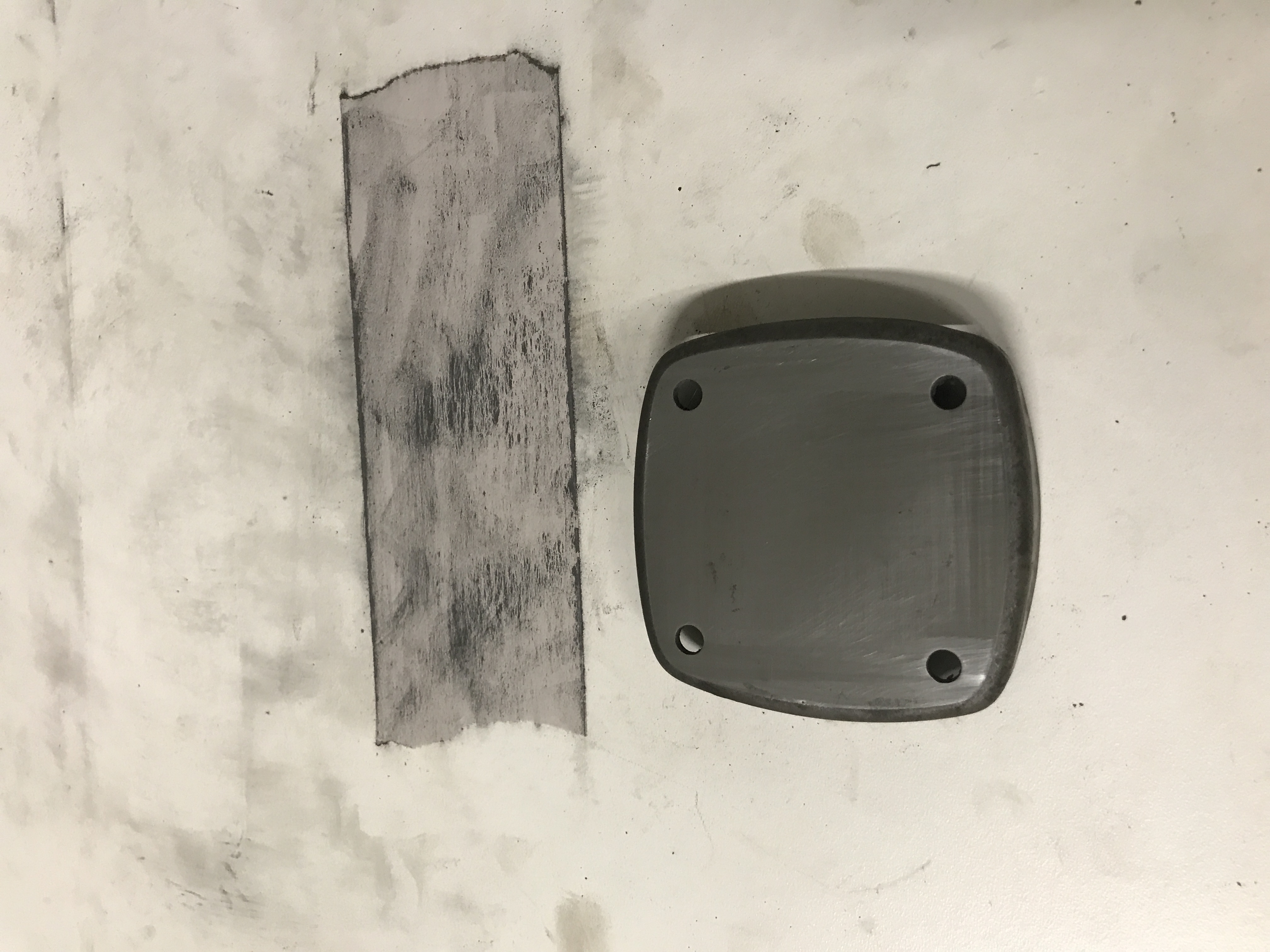

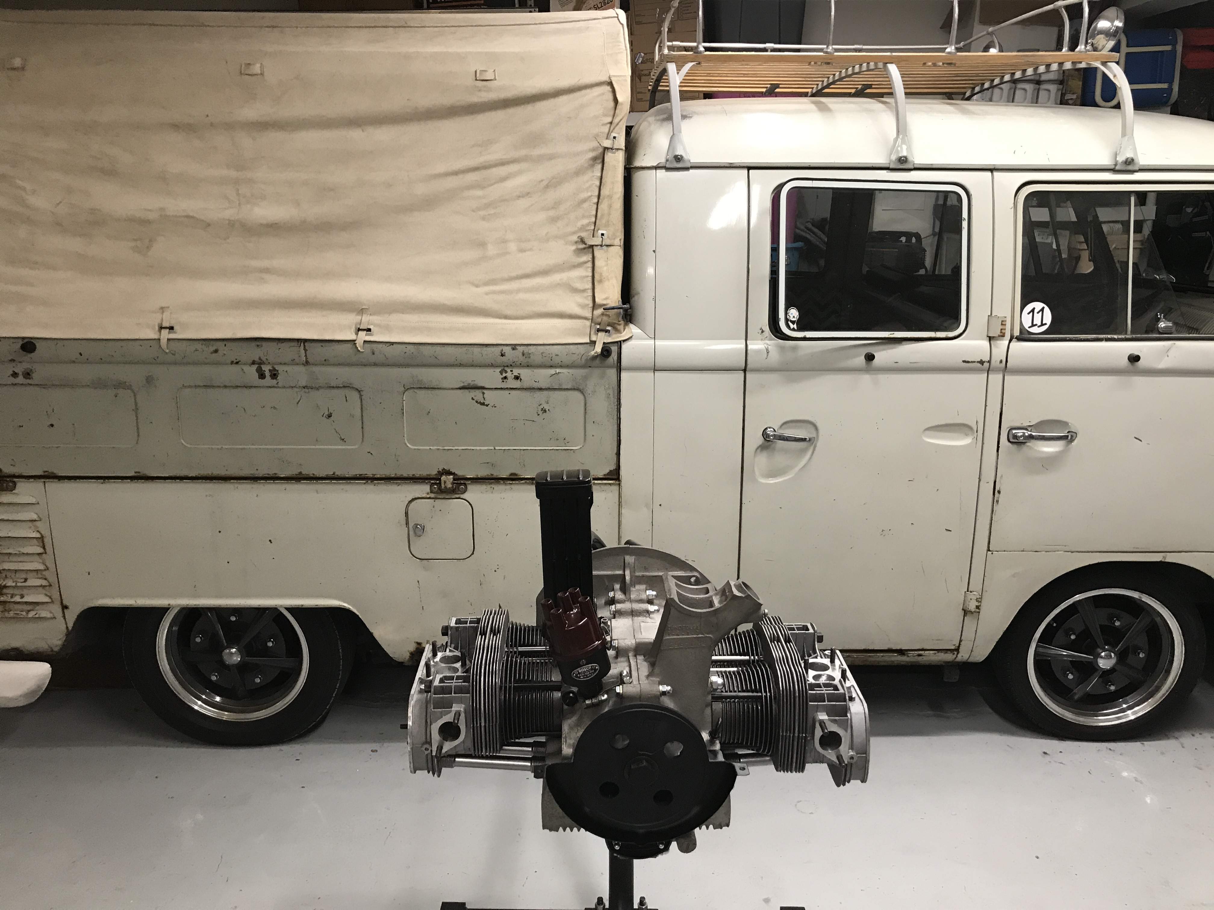

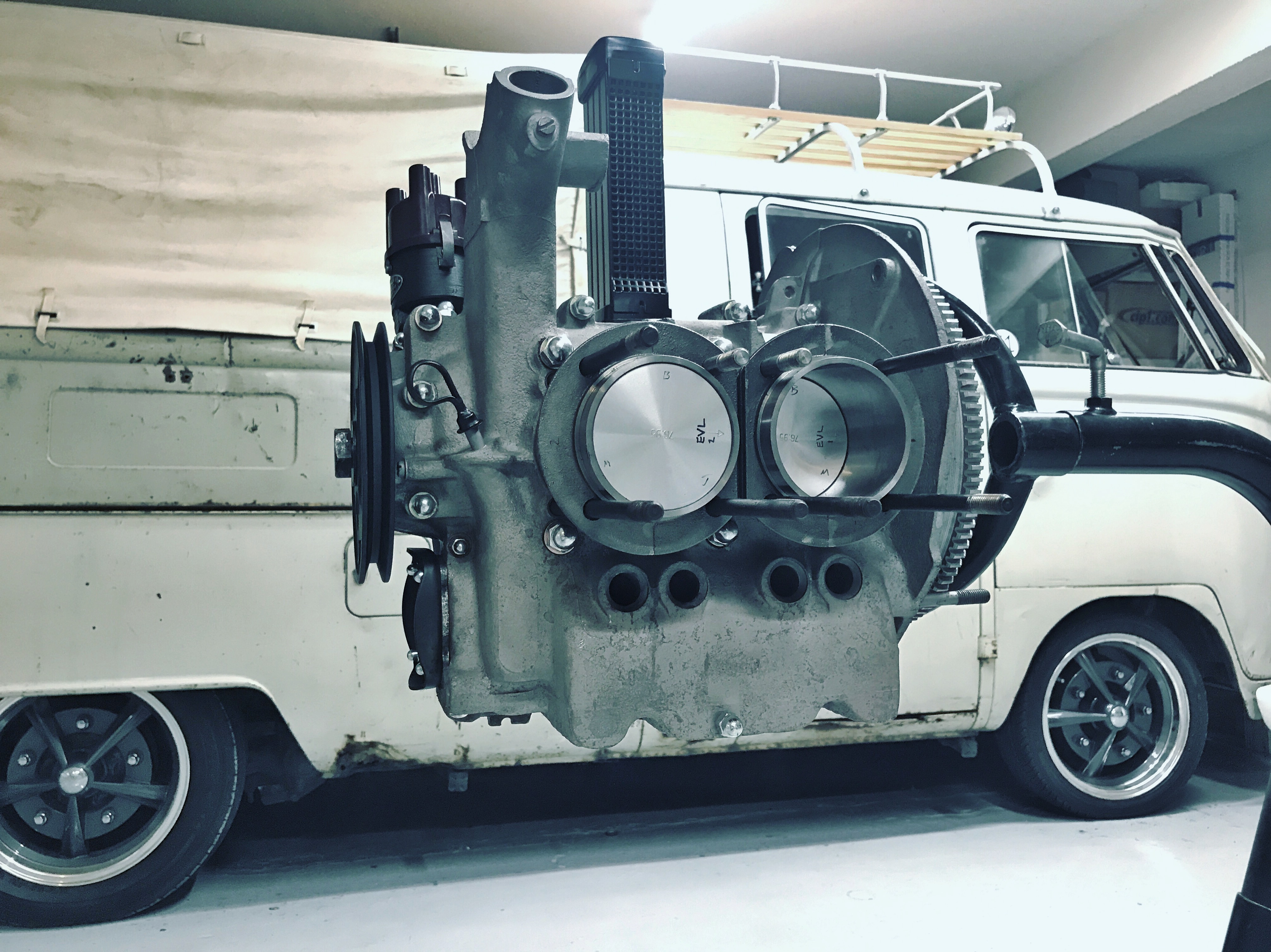

Push rod magically slides like butter now? No clue.
Lapped the oil pump cover with 400
