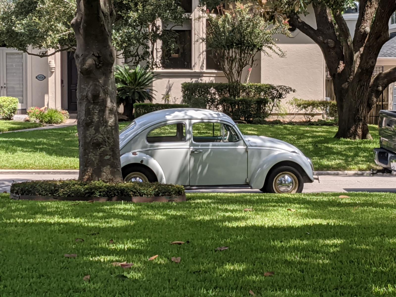

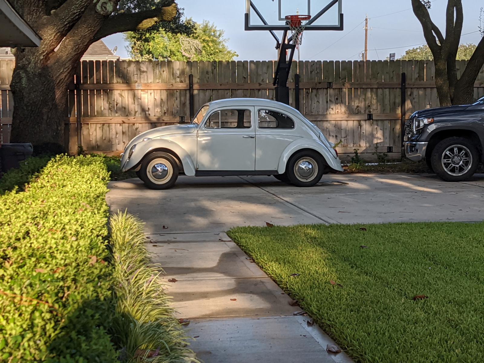

Just picked this up back in September. It's a '63 seemingly very original bug. A police officer in my neighborhood that knew I was into VW's stopped by and offered it to me for sale. Long story short, i was on the fence whether to buy it or not, the passenger side seat recliner accessory pushed me over the edge. Since owning it I have got it running really well (its a much later 1600CC), rebuilt the headlights, fixed all of the electrical (horning ring too) put the front bumper back on, etc.

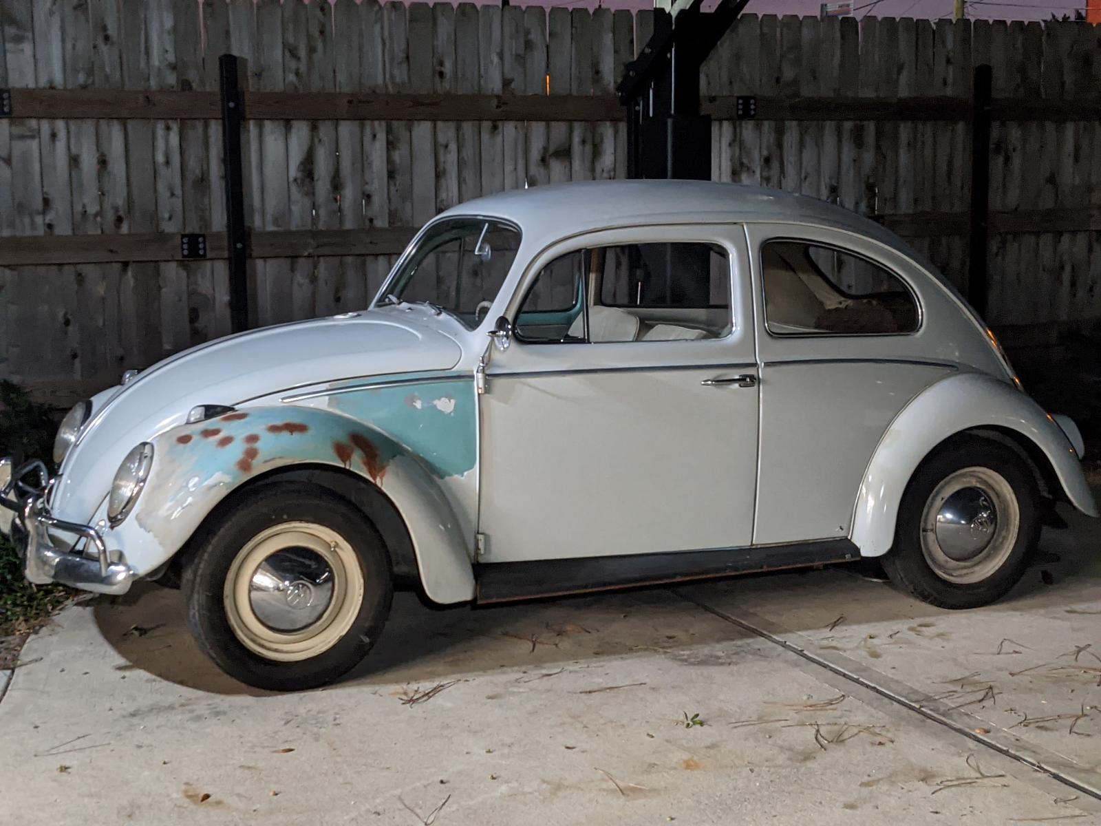

In the pics you can see I started to strip off the crappy white re-spray to reveal the OG L380 turquoise color. My initial plan was to go with the patina OG look but I hit a roadblock. The body appears to have been prepped using a scotch brite pad to etch the old surface for the white re-spray paint job (no problem at all getting to the OG paint). However the fenders were clearly prepped using a DA sander because once I started stripping the white I was hitting bare metal in several spots hence the OG paint is probably to thin or there's not enough left for me to preserve. Additionally I can see why the car did not have the bumpers on it when i bought it. It appears to have been hit (mildy) on the driver's side rear quarter at some point in its life and the rear bumper mount is kind of messed up. the rear clip and apron appear to be fine and the decklid lines up properly. But both back fenders are crappy repros. So i am not too sure what I will do for paint and body for now.

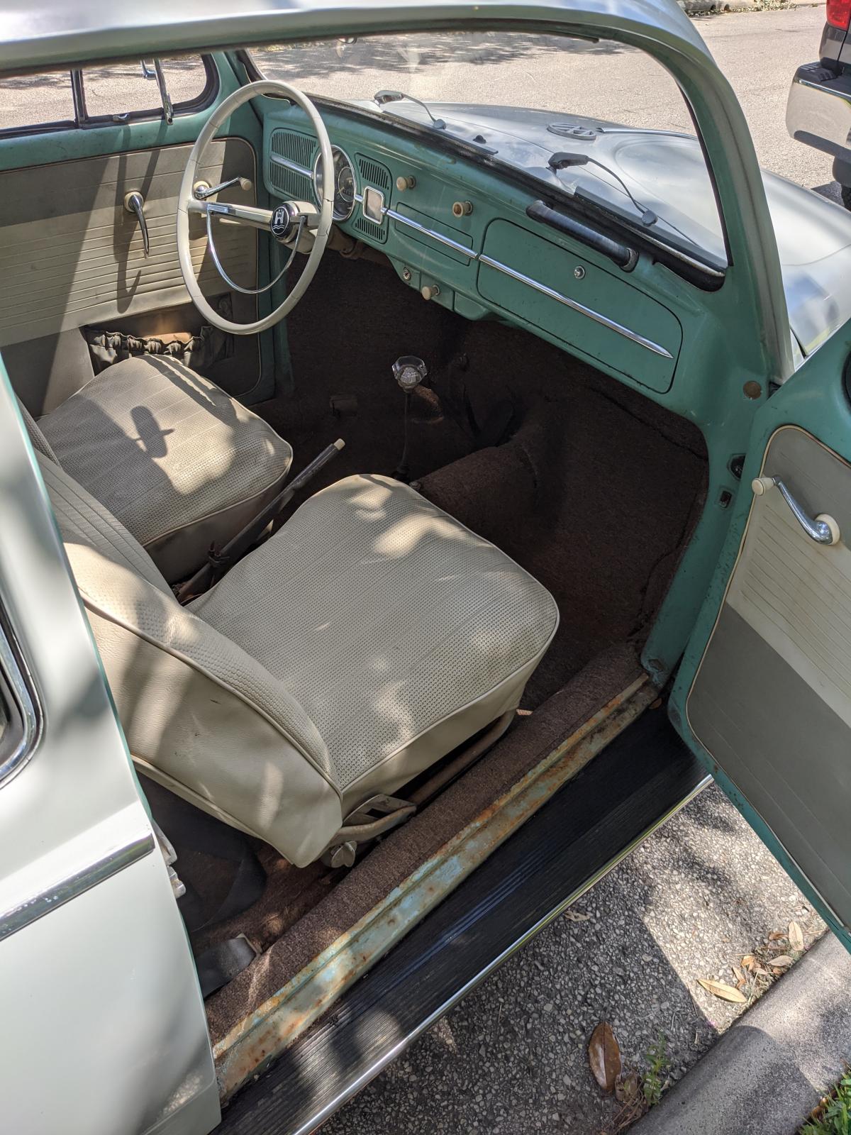

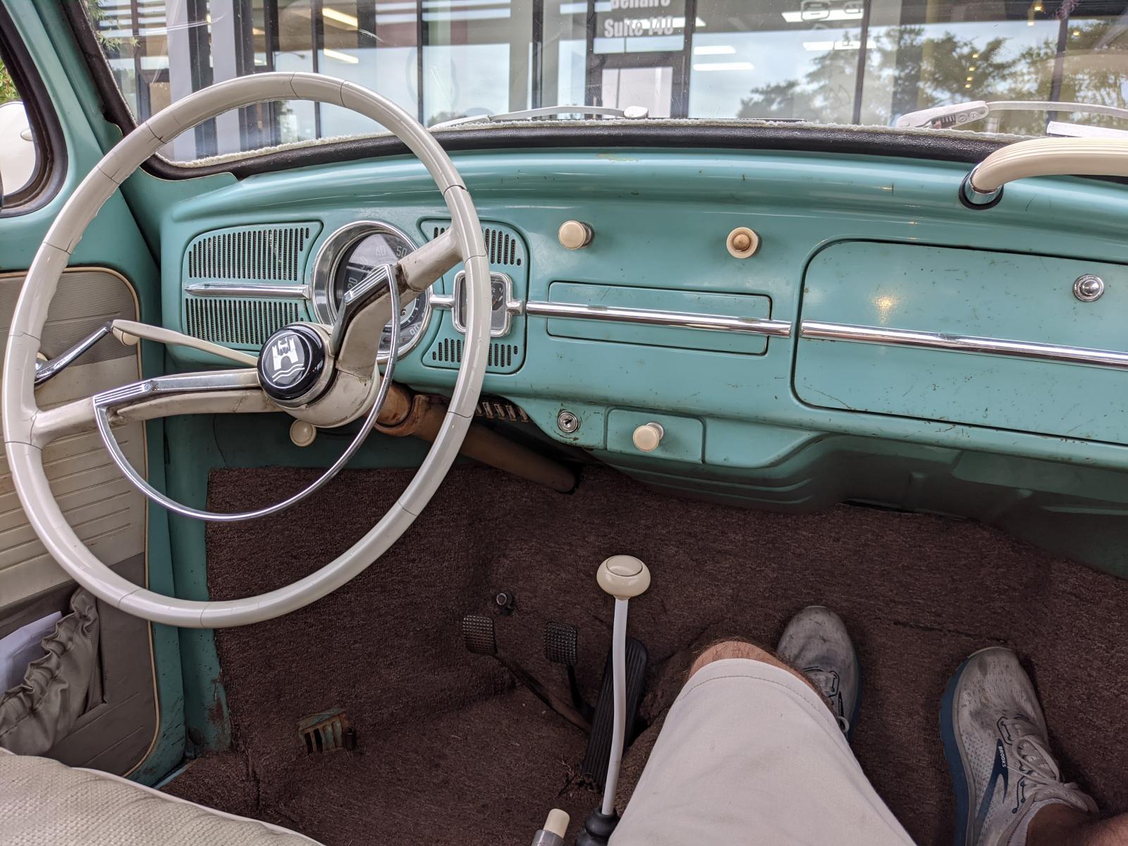

Regarding the interior it has the OG headliner and door panels. I'm going to pop off the door panels and attempt at cleaning them with some OxyClean. I've ordered new period correct seat covers that I will install once I get a chance to pull the seats and clean up the frames. The car's front clip is perfect and never been hit, the electrical and pretty much everything is in really original and complete condition. I'm pretty sure none of the OG glass has ever been taken out of the car.

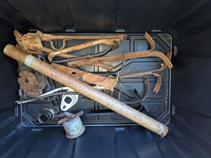

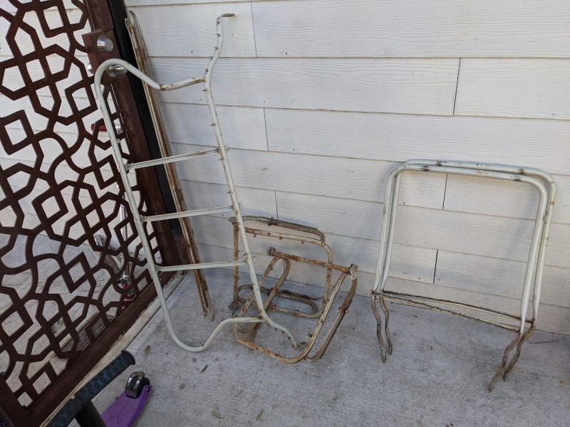

Switching gears, over the weekend I stripped down the interior to get everything ready to send out for powder coating. Do any of you guys have recommendation on powder coaters? Note I am in Houston.

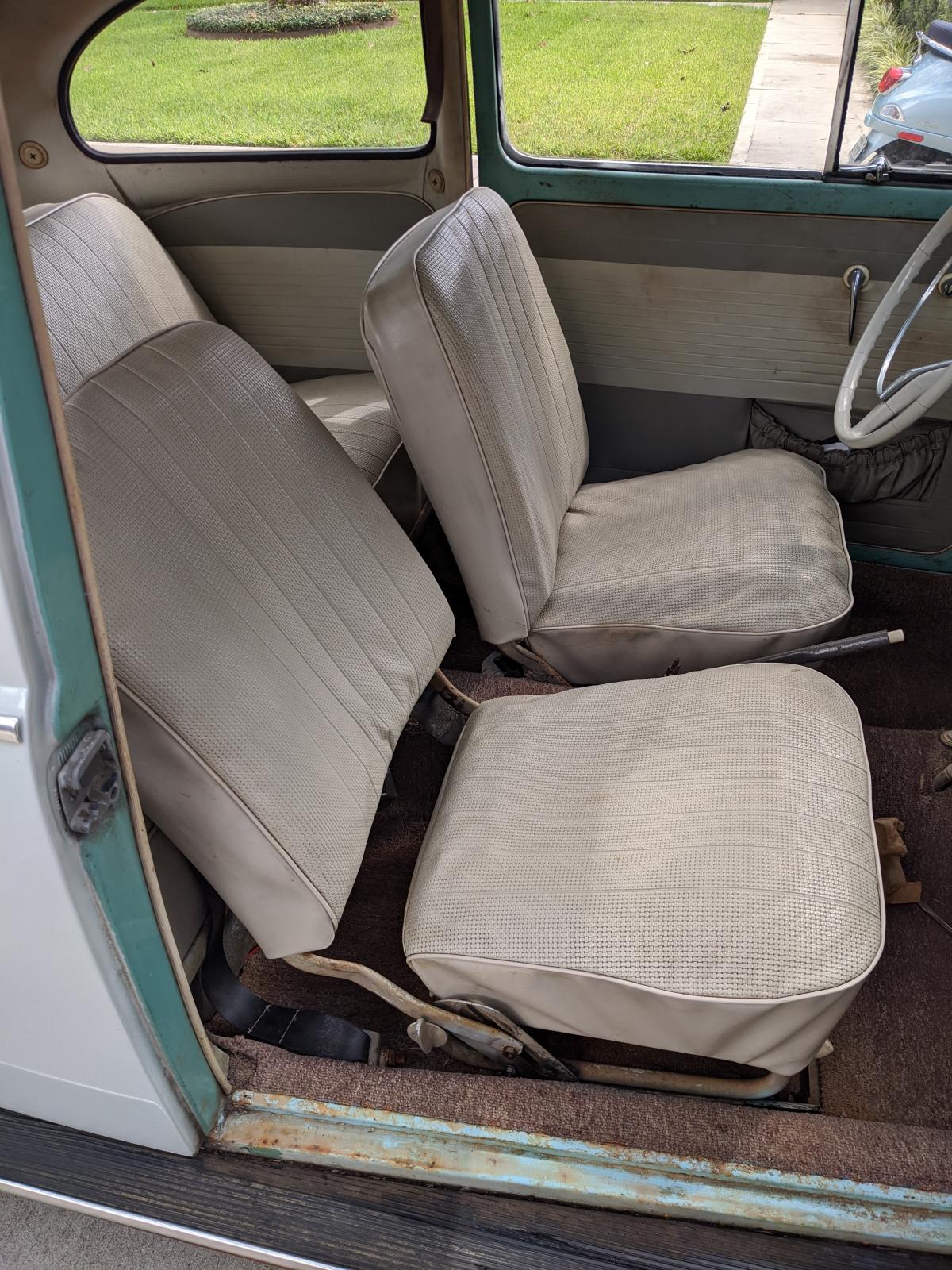

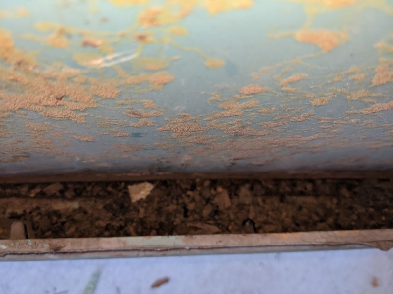

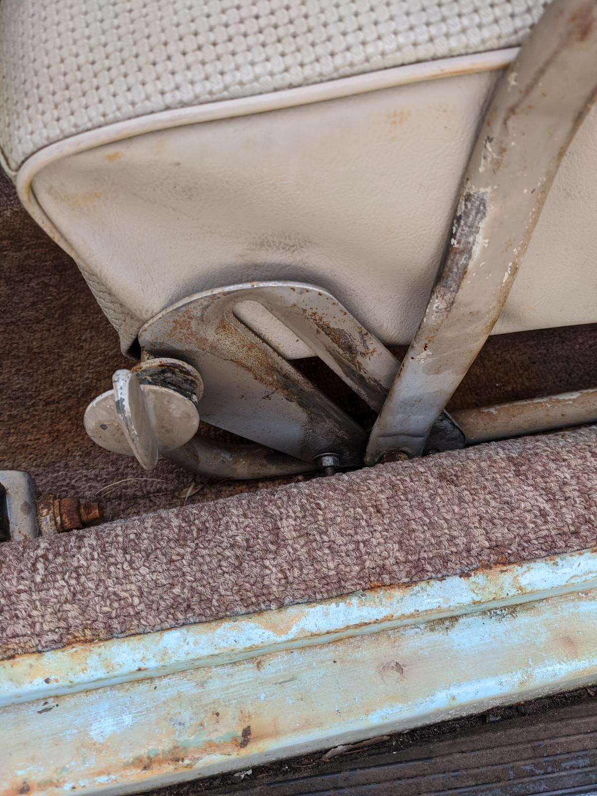

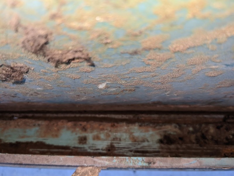

I also pulled the OG door panels. I really got to this car just in the nick of time. The window scrapers both outside and in are bad shape to say the least. They've let in dirt and water. The bottom of the doors were filled with nasty damp sludge. When i pull the doors for hinge pin replacement I will power wash them because there is only so much a shopv-vac can do with mud. Although there is surface rust in the bottom of the door they're still really solid. I do see the drivers door bottom corner closest to the A pillar does have filler that once the car is blasted will need a patch panel.

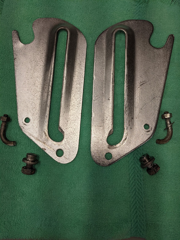

I also pulled of the Volmac seat re-cliners and cleaned them up a bit. Note seeing these on the car is the only reason why I bought the car to begin with.
