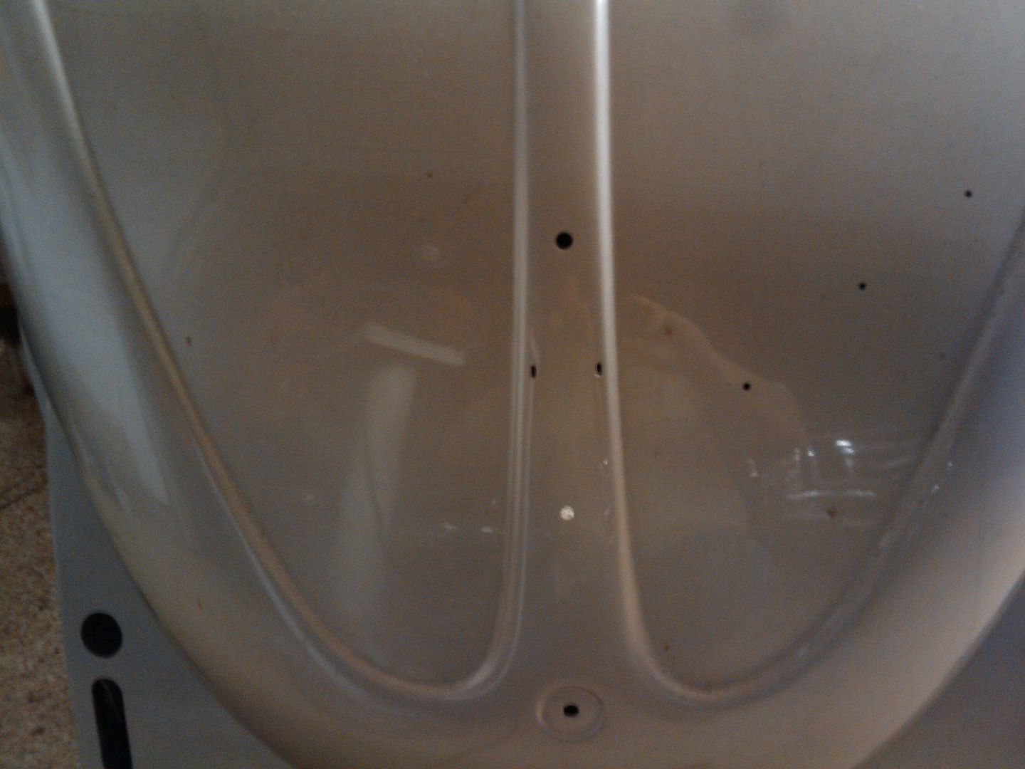

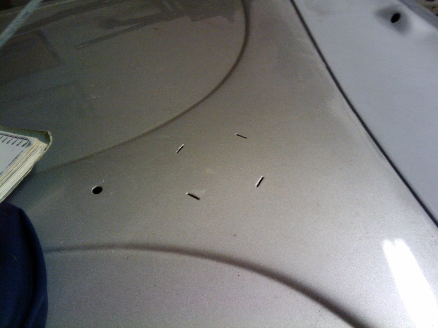

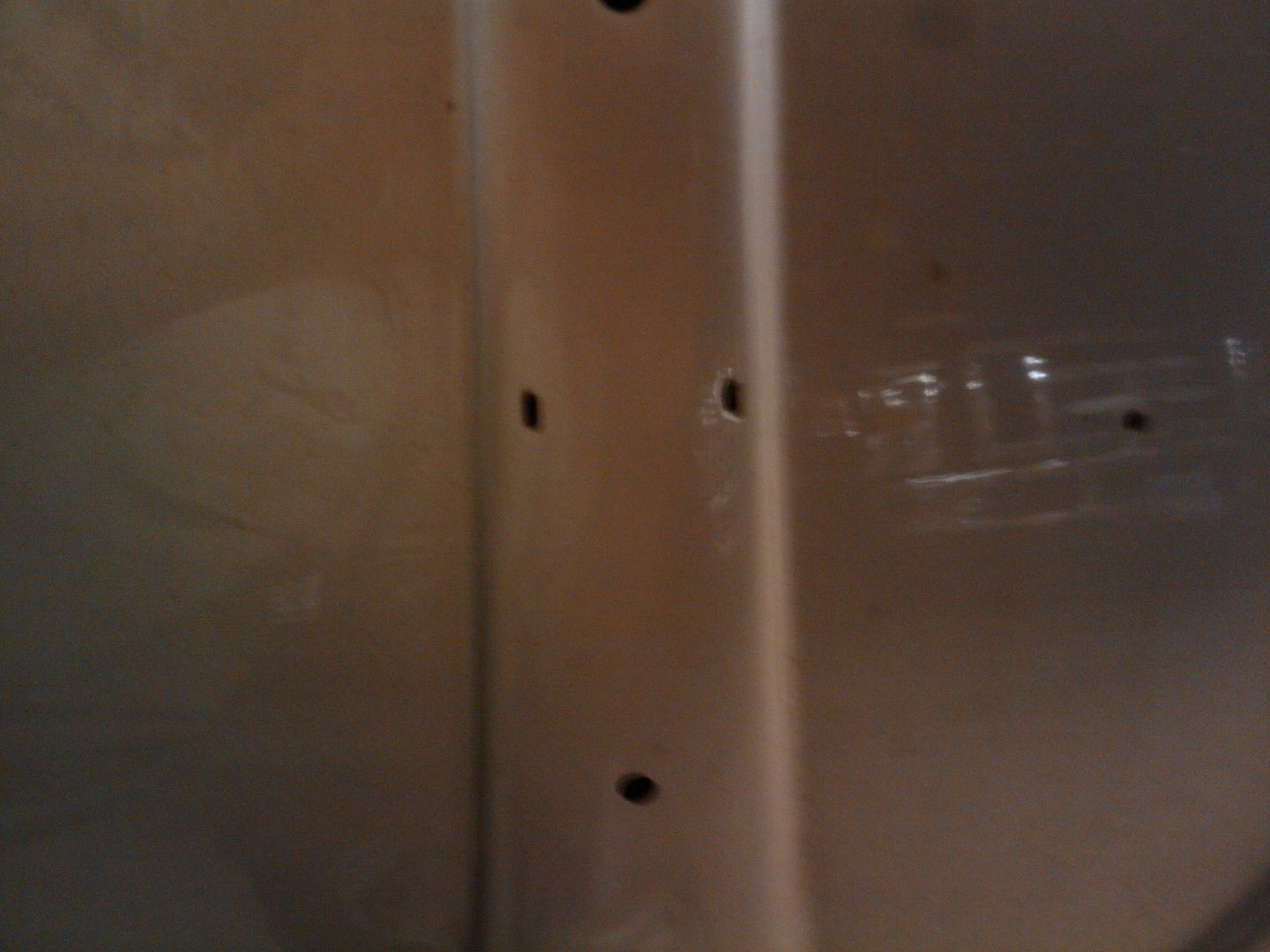

Thanks - Can you send me a close up picture of the crest area?
 Post subject: Re: Kbug's 61 - Eugene
PostPosted: Tue Oct 05, 2010 8:03 pm
the crest area just has two slots cut in
In case you are wondering what the other three holes in my hood are from
this is my 61 when I first got it
The VW emblem area should be flat like this
and depending on what month should have the four tabs, or the special 3 tab 2 piece emblem

Cool thanks. The hood is set up with a 3 pin emblem
PostPosted: Wed Oct 06, 2010 7:00 pm
61 did not have the raised area where the emblem goes 4 tab or 3 hole...my 61 is a late car it has a three hole hood
