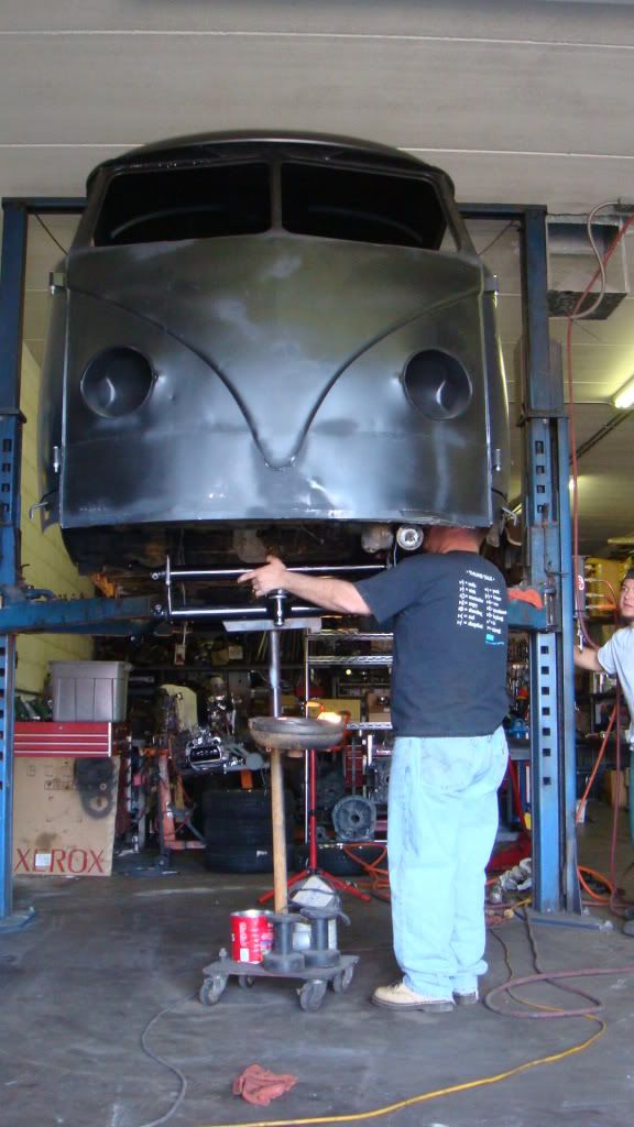

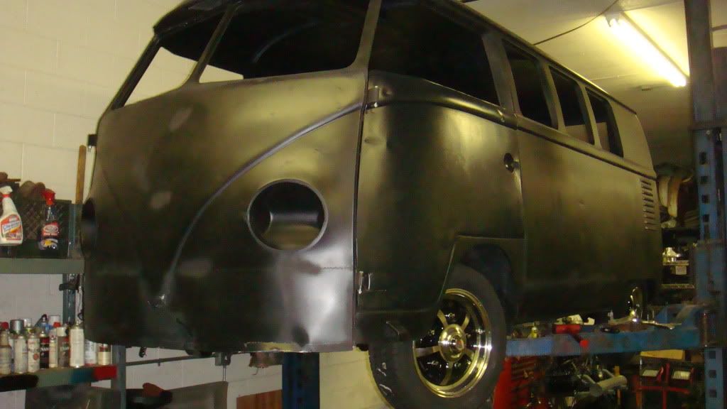

So the soda blaster people had the bus painted in black primer when they were done with it.
I got it back and got to work:

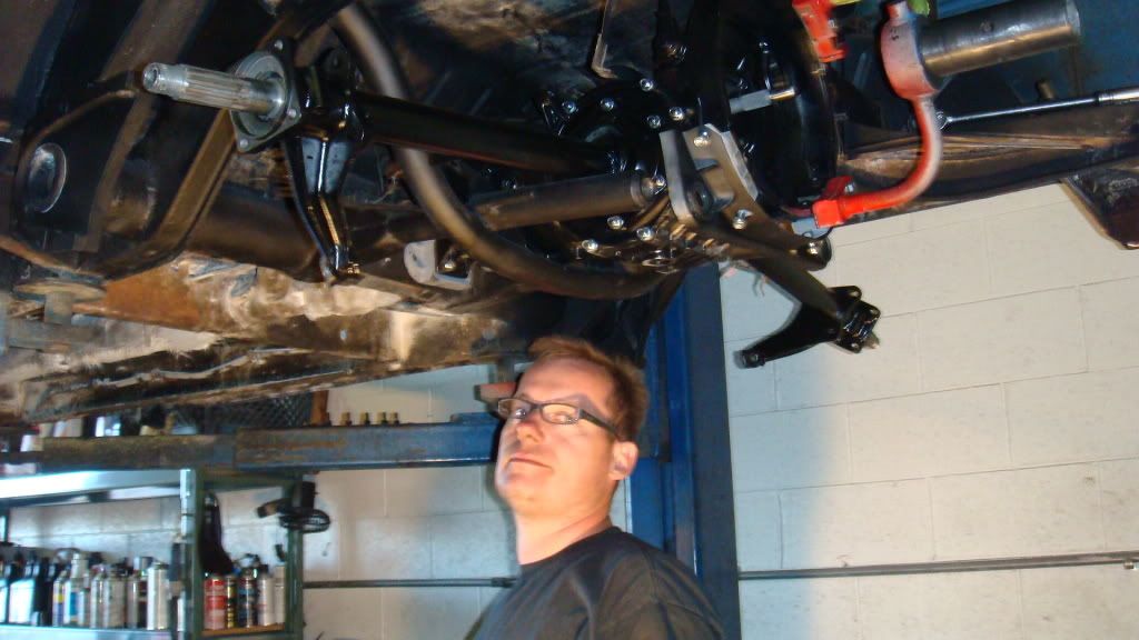

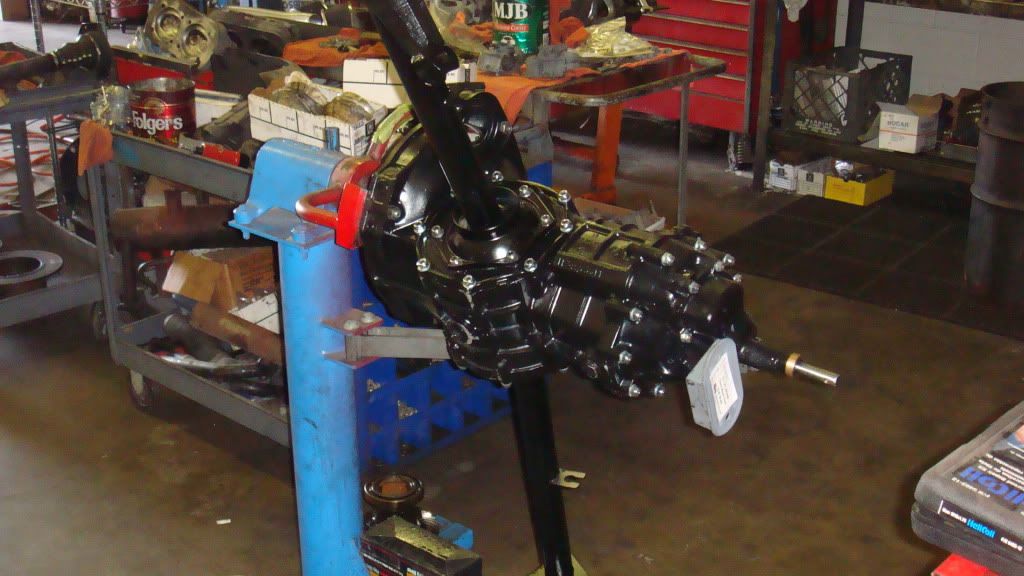

Rebuilt trans with 3.88 ring and pinion and straight axle kit (still have the OG trans complete with reduction boxes).

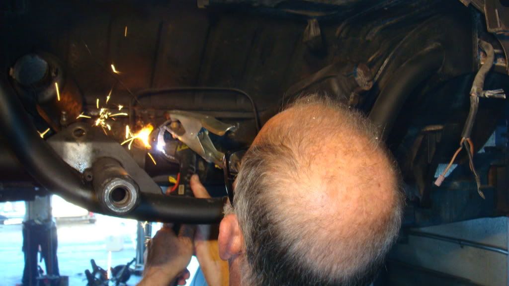

Notice the tubular barndoor/Wolfsuburg only trans hanger. Plasma cutting the front trans mount to modify it for a later mount (solid mount would have been waaay too loud for all the driving we do). The identy of the torch handler shall remain a secret to protect the guilty. I gotta get a plasma some day, those are awesome.
On the right is a cut up wiring harness- I will install the new complete wiring harness with modifications for semaphores shortly after this.
Thinking about all the fun we're going to have in this bus

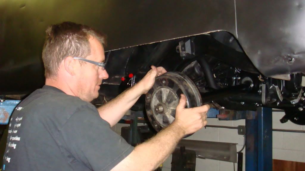

Thing drums going on so I can keep the wide 5 bolt pattern. I powdercoated the torsion bar pivot covers and bolts for a little hot rod inspired pizazz:

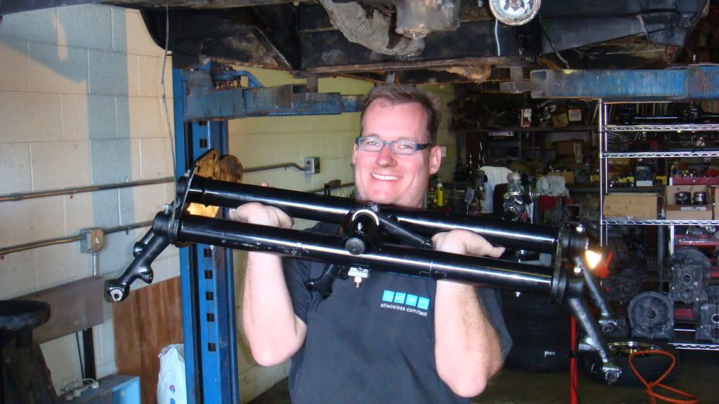

New adjustable front beam, narrowed 4 inches. Also running 3.5" dropped spindles
Almost ready to hit the floor on new Sprintstars:
