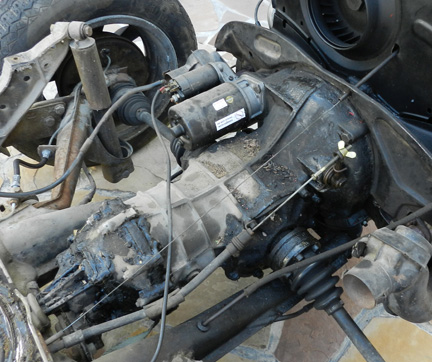

Is there supposed to be something that the accelerator cable is routed within between the rear of the pan and the engine? The picture shows how it came but i think something is missing.
 Post subject: Re: 70 Ghia
PostPosted: Tue Feb 14, 2012 5:44 pm
ya, there is a mini-bowden tube looking thing for the throttle cable to go through.
