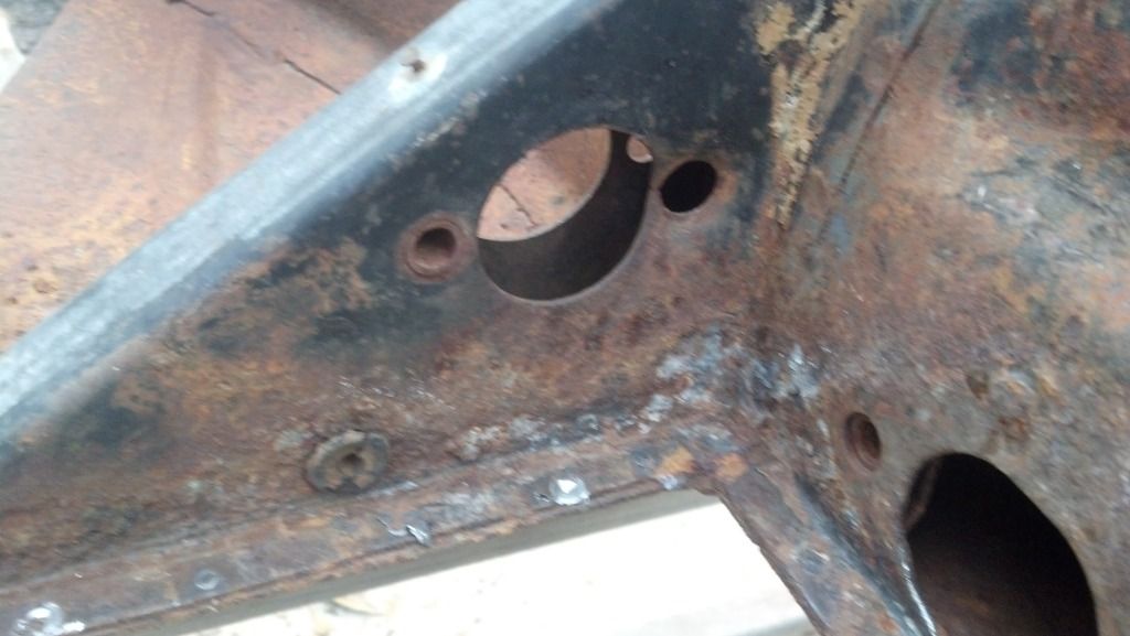

Did some more work last night. Got what was left of the drivers side pan stripped off.
Got a bunch of junk to clean out of the tunnel and have to try and figure out how to repair the master cylinder mounting area. Looks like the spacer fell out and it got crushed.

Easily fixed with some tubing.
So I don't need to worry about straightening it? Just get another spacer (maybe in there, haven't fished with a magnet yet) or fabricate a spacer and all will be good?

PostPosted: Fri Jul 19, 2013 12:42 pm
Mine was just like that and I found the spacer in the pan. Put the spacer in and mount up the mc.

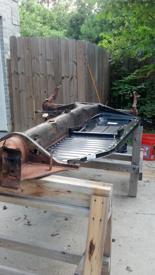

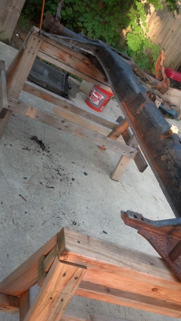

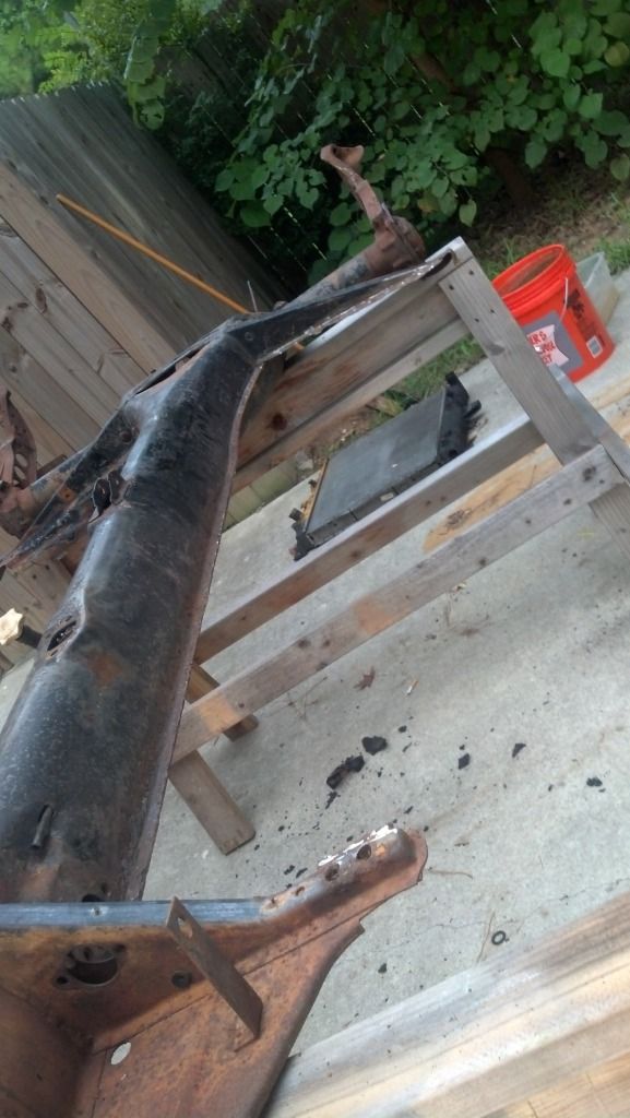

Got a little more done over the weekend in between rain and other commitments.
Started fitting DS pan
Got passenger side cleaned up

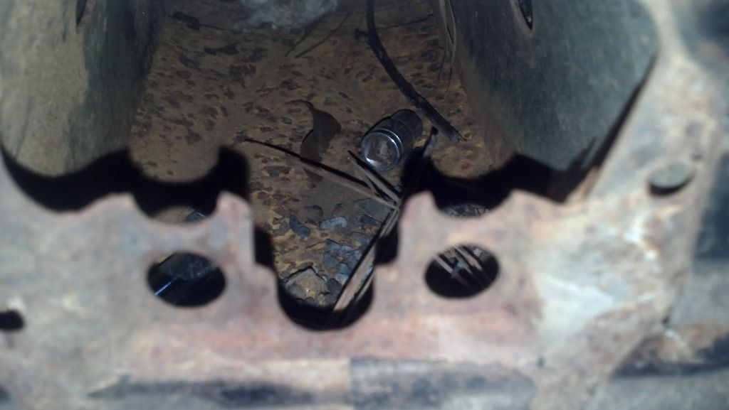

Also got the shift rod out to give us a little more room to clean the tunnel out. Also fished around inside the master cylinder area with a magnet, but no luck on finding the spacer.

Just catching up on my reading. I would order the correct wiring harness. as for the spacer that fell out. I have lost many of those over the years and I have never replaced one. the MC will still work without them. If you do have some extra tubing laying around it should be pretty easy to make.
