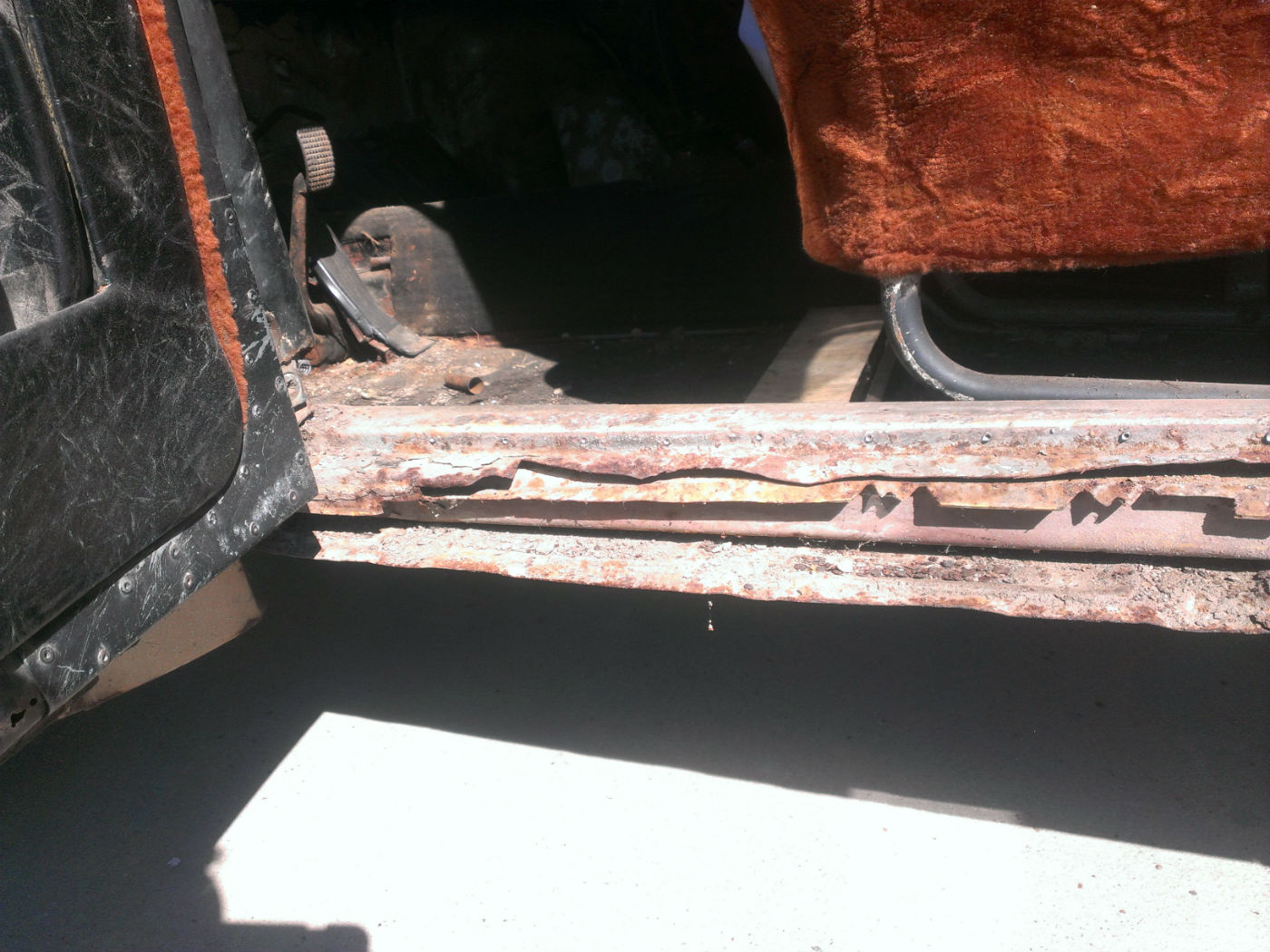

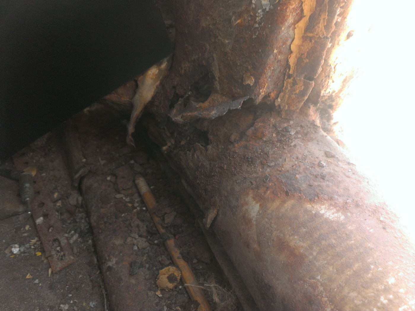

Making progress with help from Lozaro with Lucky's Fab Shop!
We found out that this car is a matching numbers car.
There's a lot of rust repair to do. Here are some pictures, we would like help with suggestions as to how to go about this. We are thinking of separating the body from the pan, redoing the pan. If you have experience doing this we need your input please.
Driver side Door Pillar
Driver side Front Wheel Well
Driver side Heater

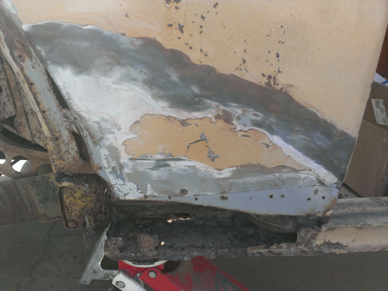

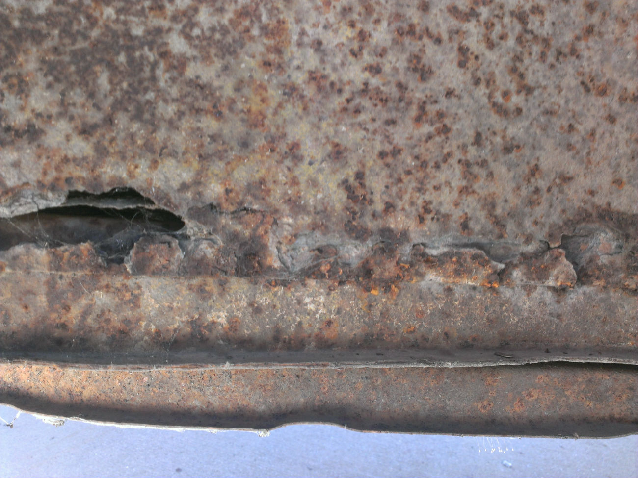

 Post subject: Re: 1961 Ragtop is here!
PostPosted: Thu Sep 25, 2014 10:21 pm
Joined: Fri May 23, 2014 9:45 pm
Posts: 44
Location: Mesquite, TX.
Driver side Heater 2
Driver side rear door pillar
Passenger side front wheel well 1

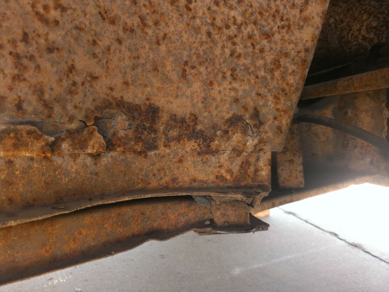

PostPosted: Thu Sep 25, 2014 10:24 pm
Posts: 44
Passenger side front wheel well 2
Passenger side quarter
More pictures coming later, if there is anything that you really want to see just ask and I'll take the picture and post it.

Ouch :shock: :shock: That's going to be a lot of work!
PostPosted: Fri Sep 26, 2014 4:33 am
Posts: 336
Cut weld repeat would be my suggestion, but for what little Ive learned that body wouldnt leave the pan before I secured the lines on the door gaps heater channels hold alot in place and those look a little soft in the pics
PostPosted: Fri Sep 26, 2014 5:58 am
Been there done that a lot of replacement metal a welder and if you can find a doner car always helps. I replaced the bottom 6 inches of My 61 rag.

Hello all,
Donor car found!
http://www.thesamba.com/vw/classifieds/ ... id=1448359
Thinking of doing this for rust repair.
http://www.kustomcoachwerks.com/movies/ ... nstall.mov
PostPosted: Sun Sep 28, 2014 12:35 pm
I couldn't open the second link, but if that body is solid why not just graft your rag clip into the body?
PostPosted: Sun Sep 28, 2014 12:40 pm
Posts: 44
Yeah that is the second link - a movie on how to graft rag into car.
