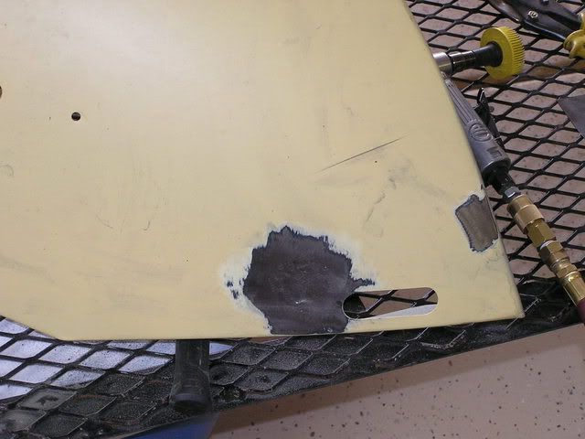

Here are your fenders Bro!
I think they look better on my car :redguy:

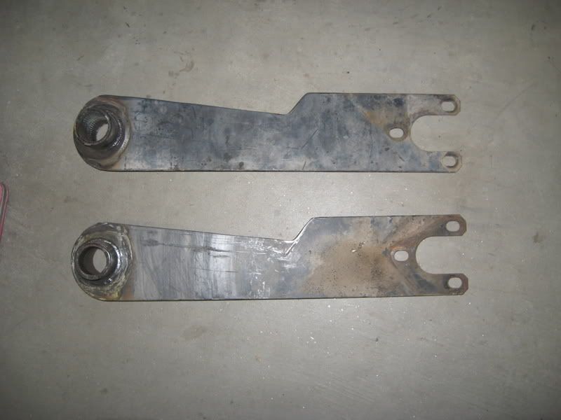

So nothing major to report. Did get the spring plates notched:

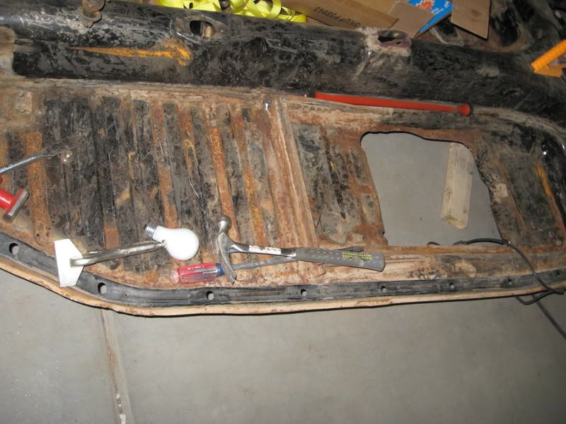

Also discussed doing this with Jeff and his hella cool neighbor Jared. Since I am doing the RHD convo, I was thinking of swapping over the brake line to run on the right. With that being done, I figured I would add a larger fuel line for a bigger motor when the time comes. With all that being done, here is the plan. I dont want to run it through the tunnel since it is a pain to do, and I have a few holes on the left side anyways.
So use one of these -6AN bulkhead fittings (one on each end):
And they will go here (where the screw driver is pointing):
And the new line would go along the pan in the old brake line position (where the torsion bar is):
As you can see I have to get the pan blasted to see how much more pan I have to cut out and replace :hillbilly:
