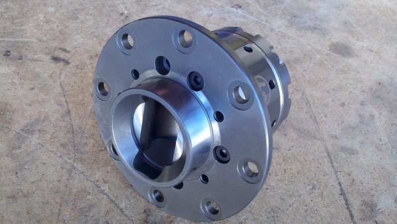

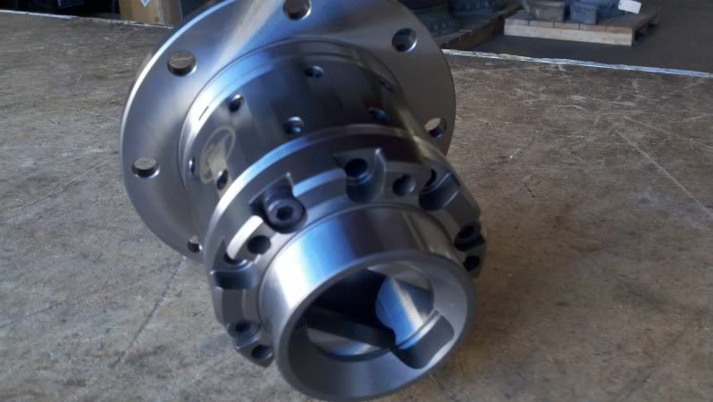

PostPosted: Thu Feb 23, 2012 9:53 pm
ATB diff 8-)
PostPosted: Thu Feb 23, 2012 10:02 pm
Pretty!
