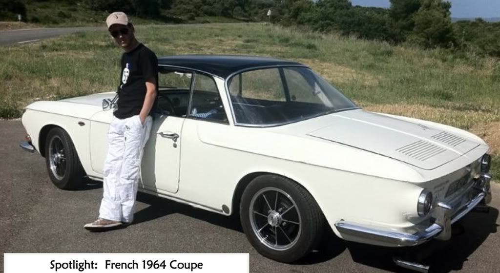

This is the color scheme I will be using on Krusty, white and black top. Wheels have several ideas

PostPosted: Wed Sep 05, 2012 8:21 pm
I hope you get it lower than that :hillbilly: :hillbilly: :hillbilly:
 Post subject: Re: "Krusty" the 62 Ghia Type 34
PostPosted: Wed Sep 05, 2012 8:23 pm
Oh I will!! Doing it tomorrow. Ran out of time today.
