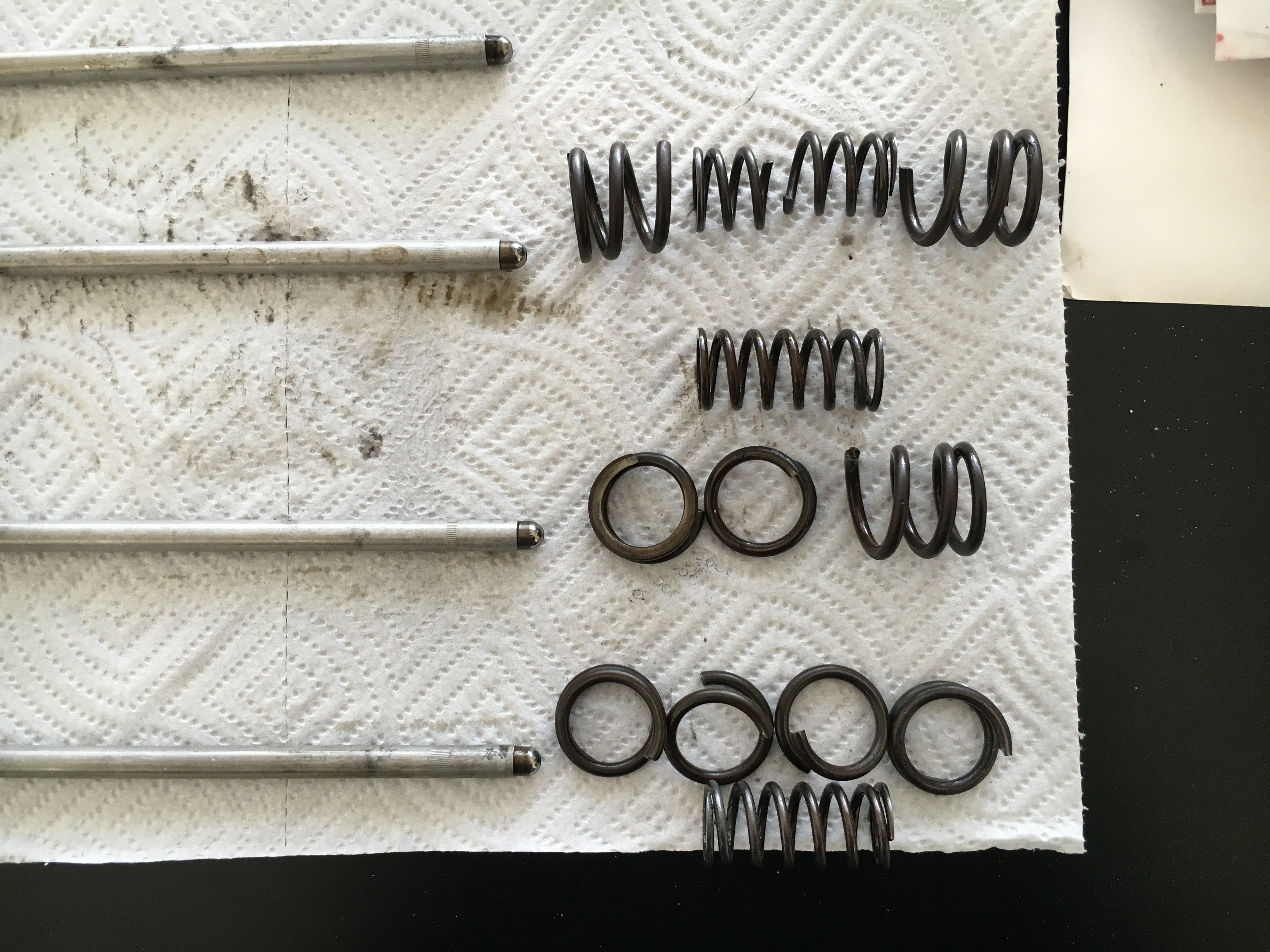

Anyone know if you can use just the outer spring from a high rev dual setup? They look identical to the high rev single spring.
PostPosted: Fri Jan 22, 2016 9:39 am
Marko wrote:
At this point change all of them.
Agreed, change them all with new duals since the heads have been cut down to fit the inner spring. Better safe than sorry...

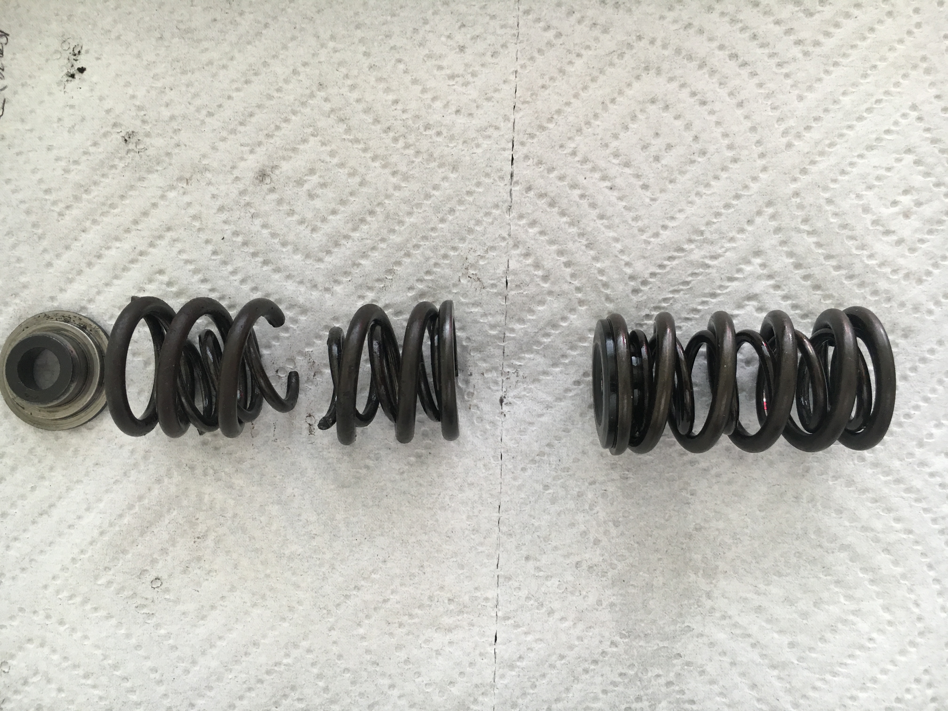

Any tips on removing and installing dual springs in the car? I'm having trouble getting them compressed far enough to get to the keepers. I got the broken ones, but the ones still in tact are being a problem. Same with the new ones going in.
PostPosted: Fri Jan 22, 2016 5:48 pm
There is a tool for that, I will see if I know someone who has one.
PostPosted: Fri Jan 22, 2016 5:58 pm
I got a cheep universal one but still it's difficult. Marlo says he has one but If I'm going to get the car done I'll need it tomorrow morning.
PostPosted: Sat Jan 23, 2016 12:19 pm
Mark brought me his valve tool. Progress is good.

PostPosted: Sat Jan 23, 2016 5:40 pm
They come out easy, but going back on is another story... :furious: :furious: :furious:
