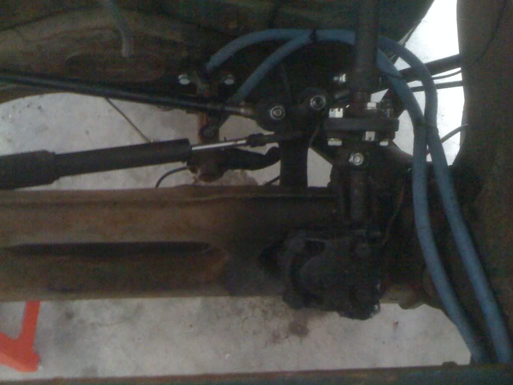

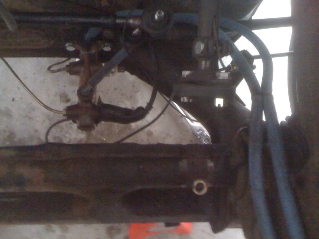

I worked a little on the Notch today,only hit a few snags....those being not being able to remove the pitman arm and the flange .

use a puller, I have one but usually auto zone rents them for free just gotta give them a deposit
usually you can just use a chisel and hammer it inbetween to put a bind on it and smack the arm a few times and it takes them off
 Post subject: Re: Chuck's '65 Notchback
PostPosted: Tue Apr 26, 2011 9:00 pm
Or a pickle fork :thumbs:

why are you taking it off?

Need to put it on the new steering box.

Chuck, I'm not trying to insult your intelligence but you completely removed the bolt that clamps it on right?

That's the problem,I can't get it out....

I'm pretty sure you need to get that bolt out before you can pull the pitman arm.
