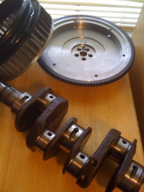

I just picked my parts up from the machine shop, had everything balanced and the 71mm crank polished, turned out awesome. The flywheel is a lightened(12.5lb), forged 200mm conversion flywheel, I'll be running that till the 091 is installed. I still need to get my 228mm flywheel lightened and resurfaced.
There is a woldwide shortage on type 4 bearings, mine look/measure good, so i'm going to have PolyDyne coat all the bearing and run what I got(this is just a mild 2L build afterall). 2 weeks ago Silverline released STD/STD bearings, they have a bad history so its hard to say what will come out of this. I do have a set of Mahle STD/STD's that i'm rat holing away for my future turbo build.
My engine build is back on track.

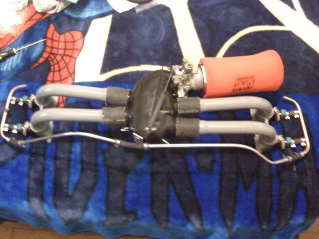

while i'm waiting on the heads to get tuned up i've been busy getting all the little details handled. I'm very OCD about hose clamps, luckily I found some intake runners on the samba that had 13 of them still attached and I have an extra set of stock injectors...score!
I mocked up the stock bus FI just to make sure everything jives, its a crappy photo as usual :hillbilly:
PostPosted: Mon Jan 24, 2011 1:00 pm
That's cool looking :thumbs:

PostPosted: Mon Jan 24, 2011 9:39 pm
Looks nice :thumbs: :thumbs:
PostPosted: Mon Jan 24, 2011 9:53 pm
Looking Good! :thumbs:
PostPosted: Mon Jan 24, 2011 11:32 pm
Better than no photo! :thumbs:
