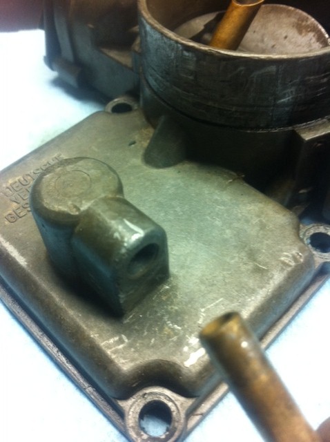

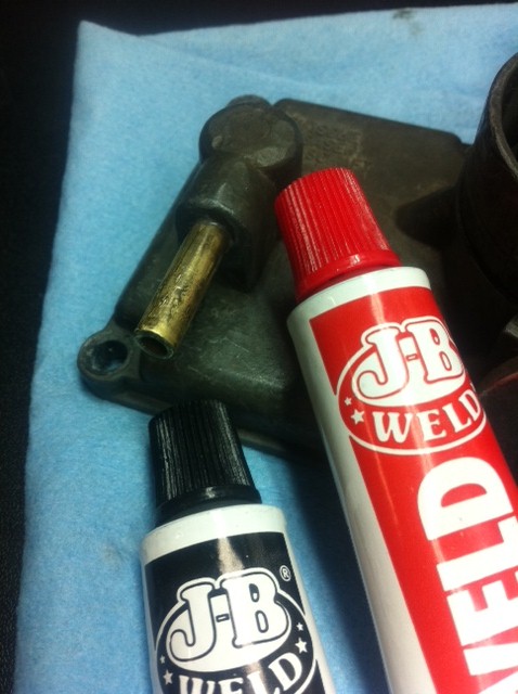

I am going to try tapping it and JB weld.. :hillbilly:

That's a common area for them to leak. That leak has caused more than one VW to go up in flames :shock:
You can probably work the brass tube out, put a little chamfer on the carb where it goes in, then re-assemble it with a little JB Weld.
Thanks Brian, I will do your way.

Hope it work. :thumbs:
leave it overnight.
