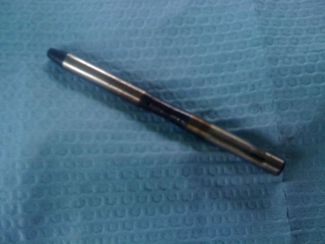

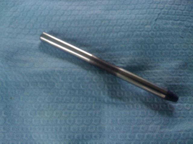

So I needed some more monsters and decided to take the bus, used the exact same route and the exact same thing happened. It was after a traffic light getting up to speed on a feeder road, so a long period of higher rpms. I'm going to pull the fp and look at the rod, I suspect it's mucked up and binds when the engine warms up. I did get into 4th and that gear seems to be a little quieter now and didn't kick out of gear :dance: .

Here is some pictures, I was starting to turn into Nate w:pw
after polishing it

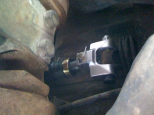

and some random eye candy :thumbs:

I read this somewhere ... The sleeve that the rod runs in like you said could be binding. take the bakelite sleeve out and sand the outside some. This will allow some room for expansion. Just a thought.

It could be that Wayne but it's now doing it when the motor is cold too. It's going to have to wait until Friday, I'll rebuild the fp and check the hard fuel line and the nipple coming out of the bottom of the tank. I suspect one might be clogged, there was only a small dribble coming out of the hardline when I reinstalled the fuel pump.
