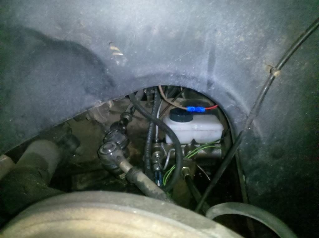

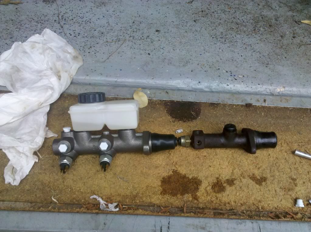

Out with the old
And in with the new
Biggest headache was getting the old metal lines to line up with the dual circuit master cylinder. I think I spent 2 1/2 hours doing the swap, and probably 75% of that was making the lines fit. Now I just have to bleed and adjust and hopefully all will be well
