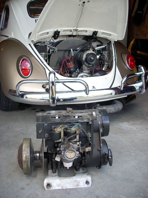

That's what I expected to find - but nope. I pulled both carbs off and checked the idle circuit passages, but they looked clean. However, I gave them the white glove treatment anyway. The rest of the carb(s) seemed to check out OK.
The points looked OK. I did notice that the dist cap is a bit chewed up on the inside; little plastic bits inside. The rotor looked OK. Thought about checking the coil - weak ignition issue? Whatever the culprit is it pops up (literally - pops) totally at random.
If all else fails, perhaps I'll have to pull the 1835 and drop in this bad boy :hillbilly:
File comment: Does anyone have a guess?
