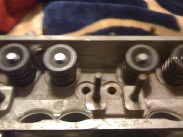

Thanks guys, I'm really excited about this build. I still haven't heard back from Rimco yet, but in the mean time I had a package waiting for me. I another set of 1.7L heads w/ 1.7L rockers(they are the hot setup and have 8mm adjusters so I can run 911 swivel adjusters now), I just wanted a set of rockers, the one set that was on thesamba sold the day before i contacted the seller. I found those heads on a poorly titled ad, now I got an extra set of heads for the next engine build, giggity! The sweetest part is that i got the heads and rockers for $25 less then the set that I missed by a day, friggin awesome!

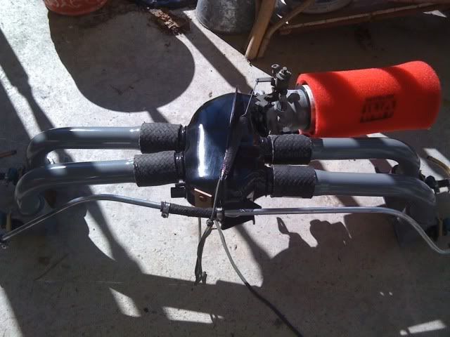

here's a better pic of the spider intake, my iphone hearts taking pics outside, not so much inside :hillbilly:

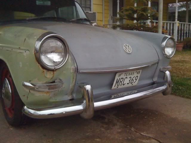

De-rusted the front apron and polished up the front bumper a bit, plus mounted my front plate...
It's merc'd the fuck out now! :mrgreen:
I got a better set of front fender's, just been too lazy to mount them :nono:
Waiting on The VW museum for the car's birf certificate.

Looking good!!!!! :beer: That intake is insane! great job :thumbs:

Thanks Eric :beer: That intake will look right at home under the engine lid. I managed to get the best angle on that front apron, its pretty damn beat up, thanks to Meredith, I got a useable front clip.

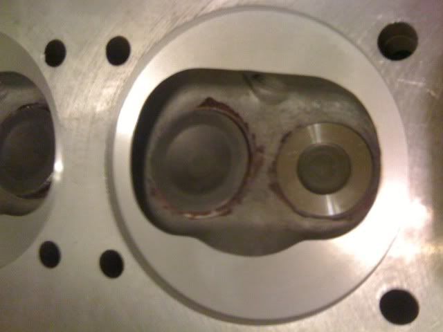

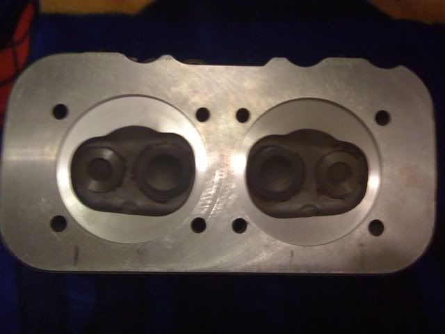

I got head! :dance:
nothing fancy here:
used 1.7L cores
new 39.3x33 valves
new 135# HD springs
new chromoly retainers
new hardened keepers
new guides
new seats
94mm bore
valve job/lap/assembly
all done by Rimco. The last of the parts will be here thursday.
