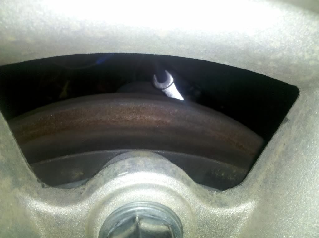

Pulled right side apart this morning and no leaks. Figured maybe I still have some air so I'll bled again. Spent 3hrs looking for my 7mm wrench. Finally gave up, went and bought another one. Came home, decided to top off reservoir. Went to pull off left wheel and look at what I found :dance: Been around the block a couple dozen times, Niftee50's, to work and it just held on tight I guess :thumbs:

awesome!!! now you have a spare
