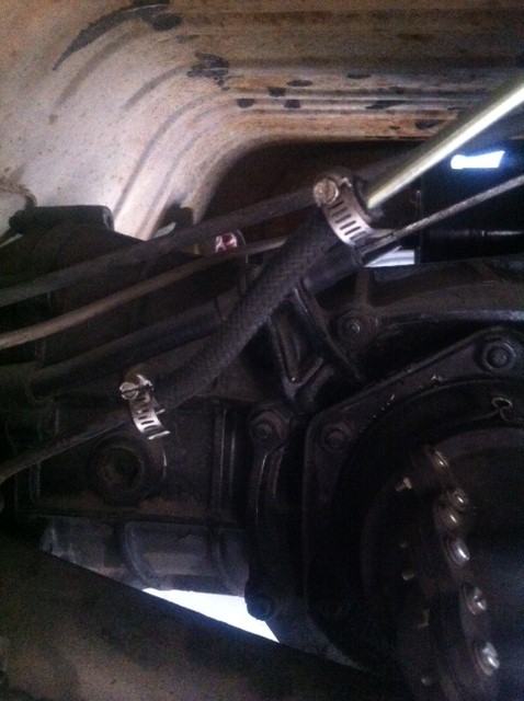

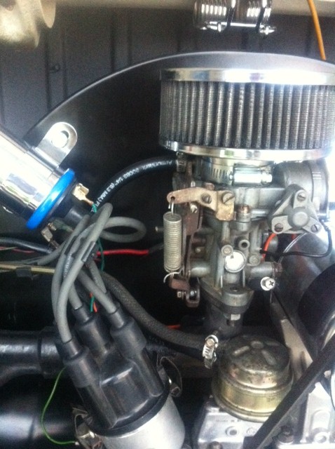

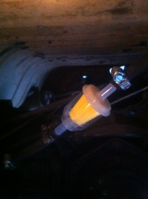

 Post subject: Re: BUG 68
PostPosted: Thu Mar 01, 2012 6:26 pm
Before
After

You didn't waste any time. Looks good 8-)
