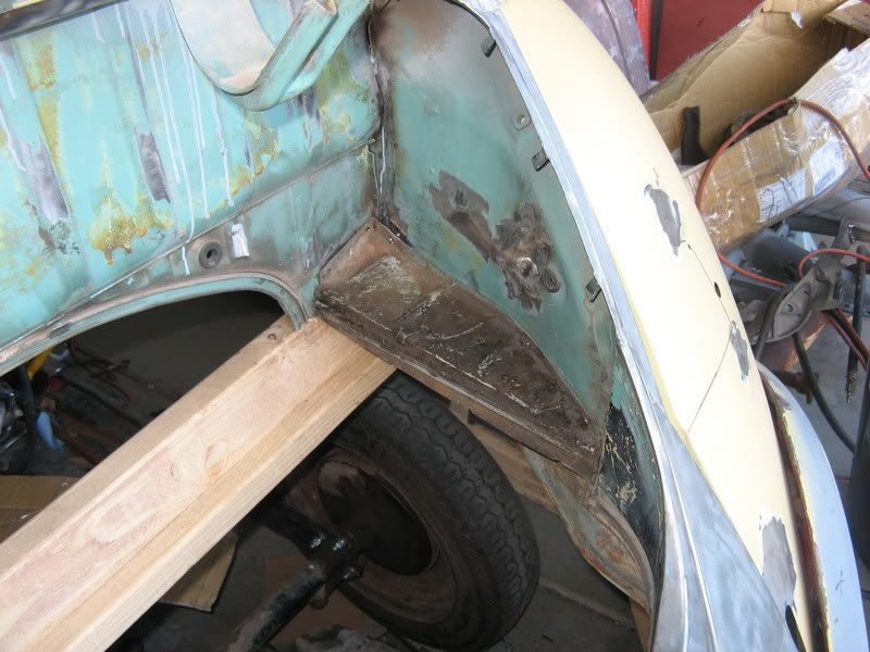

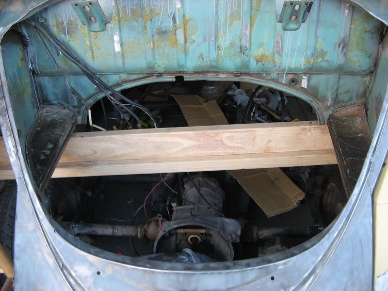

It was at least cool enough to work out in the garage this weekend. So while my daughter was taking her nap I was able to finish welding in the rust replacements. Got those ground down too. Just have to fix the front beam nuts, fab up a custom pedal mount and fit my gas line in the tunnel. Once that is done, hopefully it will be cool enough to coat the pan. I also started to cut out one of the engine shelves. Once those are cut out and fit, then the body will be ready for the media blasters :dance:

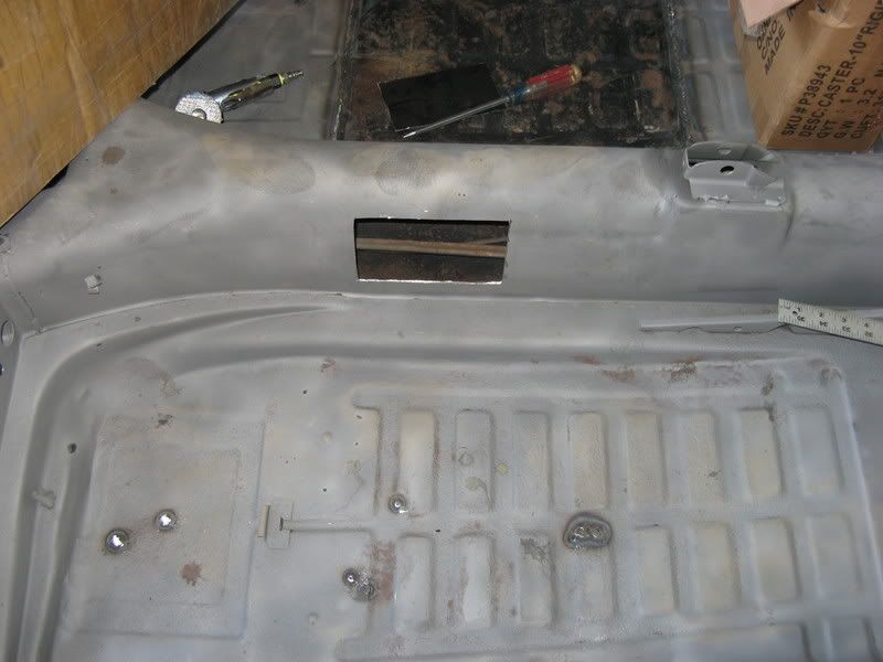

Cut another hole in the tunnel to help with guide a new gas line.(havent intalled it yet)

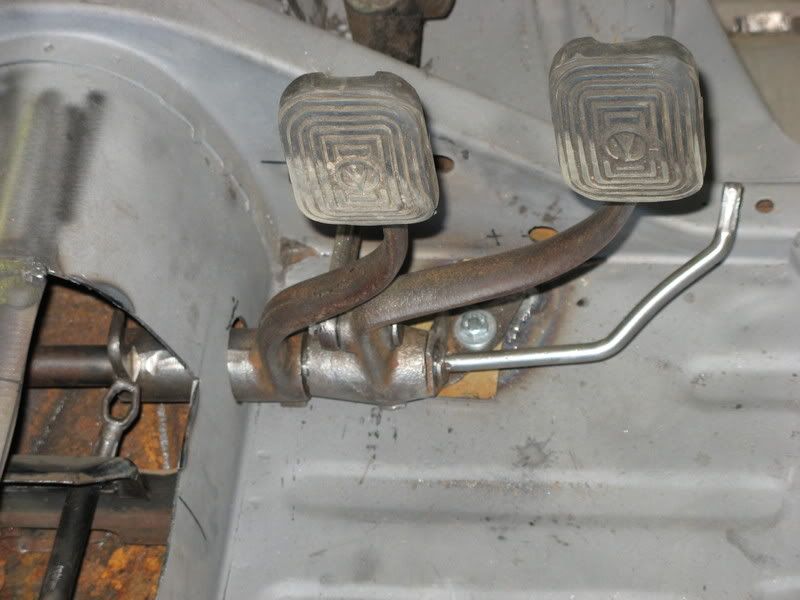

Mocked in the rhd pedals and engine shelves:
Did a few other odds and ends like drill hole for the brake line on the right side and cut a hole in the pan for the gas line in the back. Have to do some custom fab work and welding on the pan to finish that up.

where does the pedal assembly actually bolt to? on the passenger side? ( what used to be the drivers side)
 Post subject: Re: The Turd
PostPosted: Sun Sep 07, 2008 8:30 pm
Yeah it bolts to both sides. On what used to be the driverside it bolts to where the pedals used to go, and on what used to be the pass. side it has two bolts that bolt to the floor( you can see those in the pic). :beer:

the bolts I see in the pic I thought were for the pedal stops
