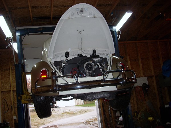

Winter is almost here - nearly 2 inches of snow yesterday. I'm going to put the Bug away for the off-season next week.
I did recheck the coil with an ohmeter and it showed within an acceptable range - so no quick fix.
I brought the Bug over to a friend who has a lift in his pole barn - very nice. It was helpful to get the car up in the air and look it over. We tightened up a few things and found a stripped bolt on the trans unit that will require pulling the motor/trans to fix. Might have to let that leak a little for right now.
I decided to check the valves. Number one cylinder exhaust valve was tight and the intake was a bit loose. A few others were a little tight so we adjusted them all by the book. I logged what I found in a little book; just to keep track.
The only other thing I might try to tackle before the winter layup is checking a fuel filter right before the electric fuel pump. I changed out the fuel filter by the regulator and it had crap in it. I suspect the first filter in line down from the gas tank would have some crud as well.
I also might pull the gas tank and have it boiled out - there is rust/junk on the bottom. However, my garage isn't heated so I might lack the motivation to do that job until spring.
For anyone who might be curious, I'm going to start a thread in the non-VW projects on my vintage Ski-Doo T'NT snowmobile. :thumbs:
File comment: Lifts are cool; beats laying on the concrete.

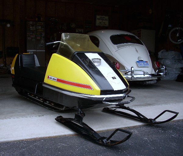

Well the Bug is put away for winter :(
The snow has started to fall ... so it's time to get out my winter project: a 1972 Ski-Doo T'NT. I've started a thread in the non-VW projects if anyone wants to see what this thing looks like. I'm pretty sure I'm the only one on the board with this type of air-cooled machine in his garage.
I'll post up photos on the T'NT thread over the winter as I try to keep my junk running, attend vintage snowmobile shows, go on some rides, etc.
File comment: Air-cool is cool - even in the snow.
