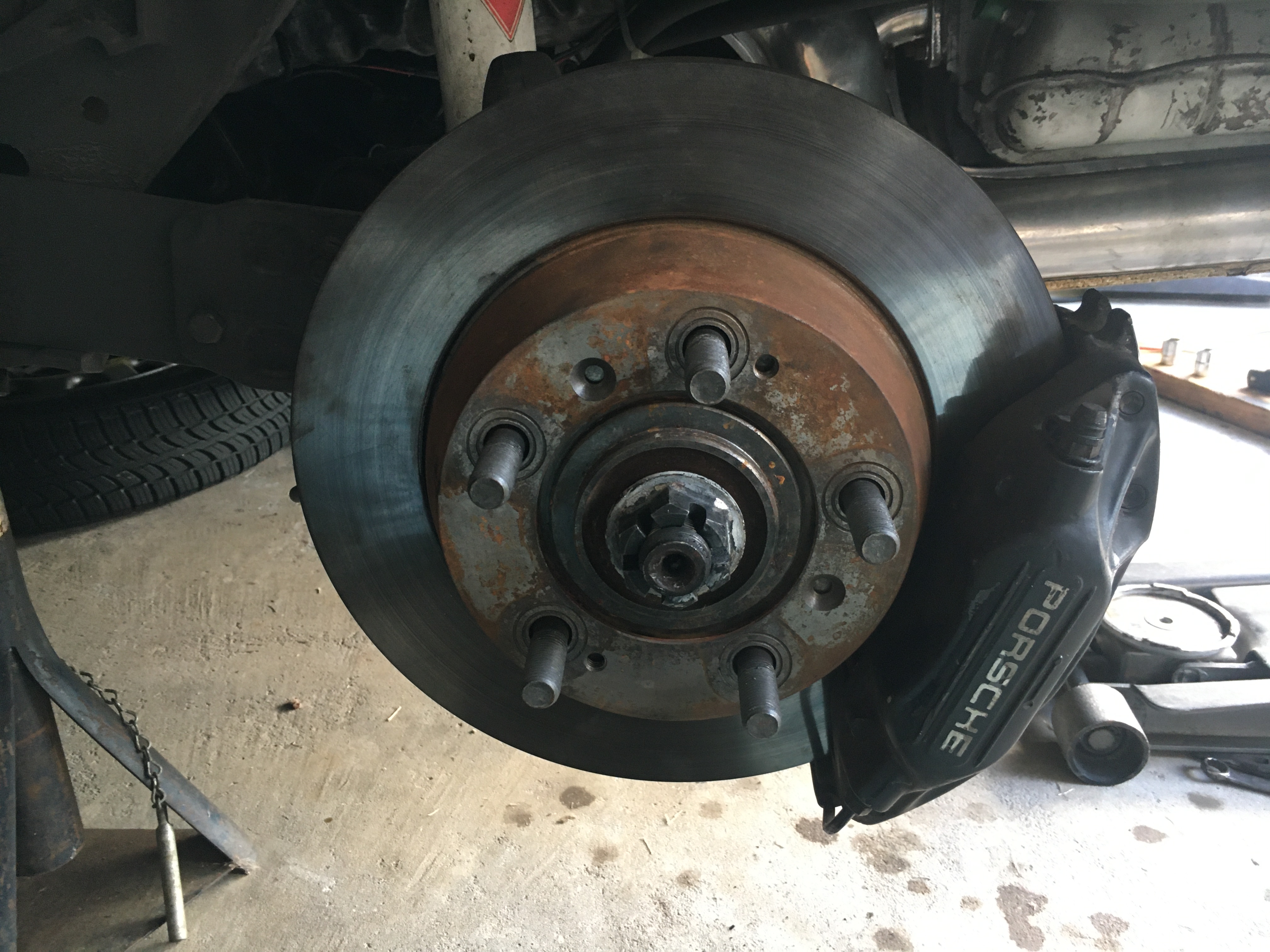

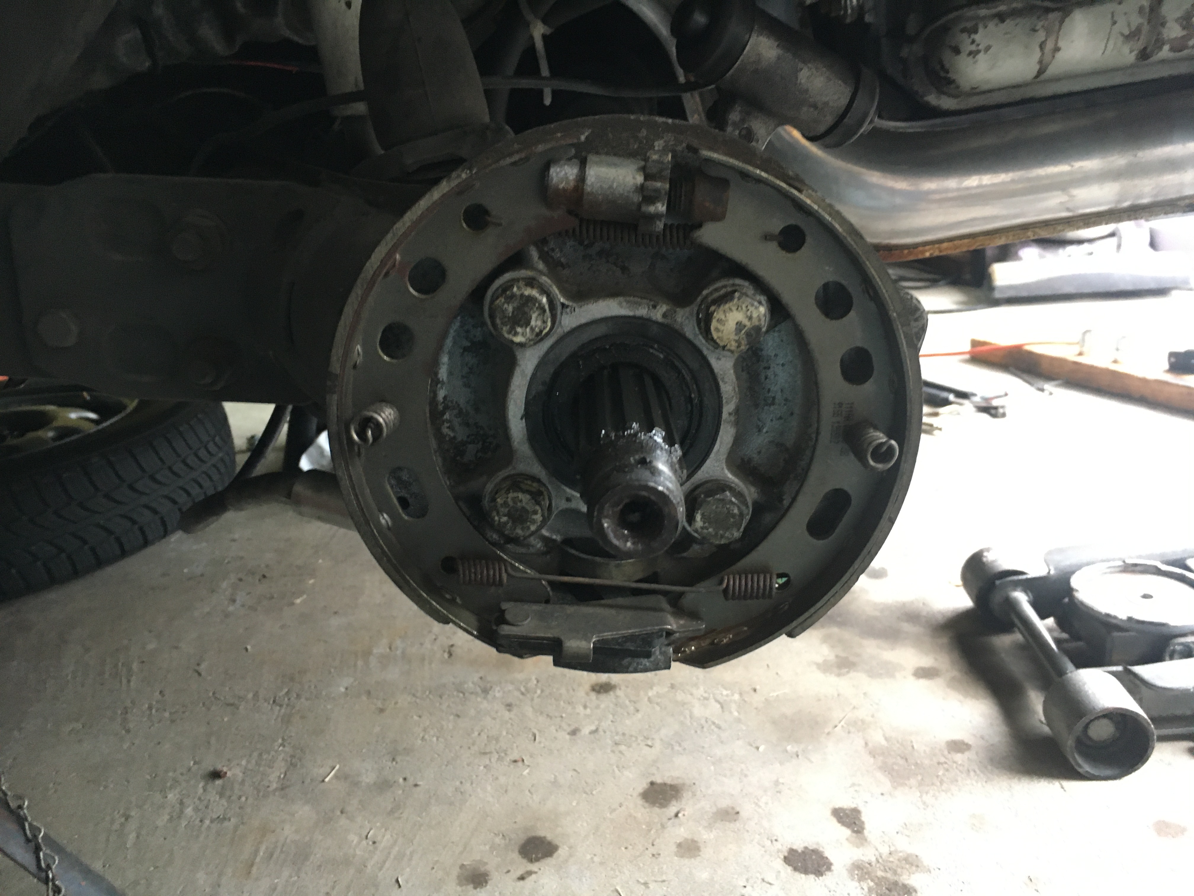

PostPosted: Mon Dec 07, 2020 2:39 pm

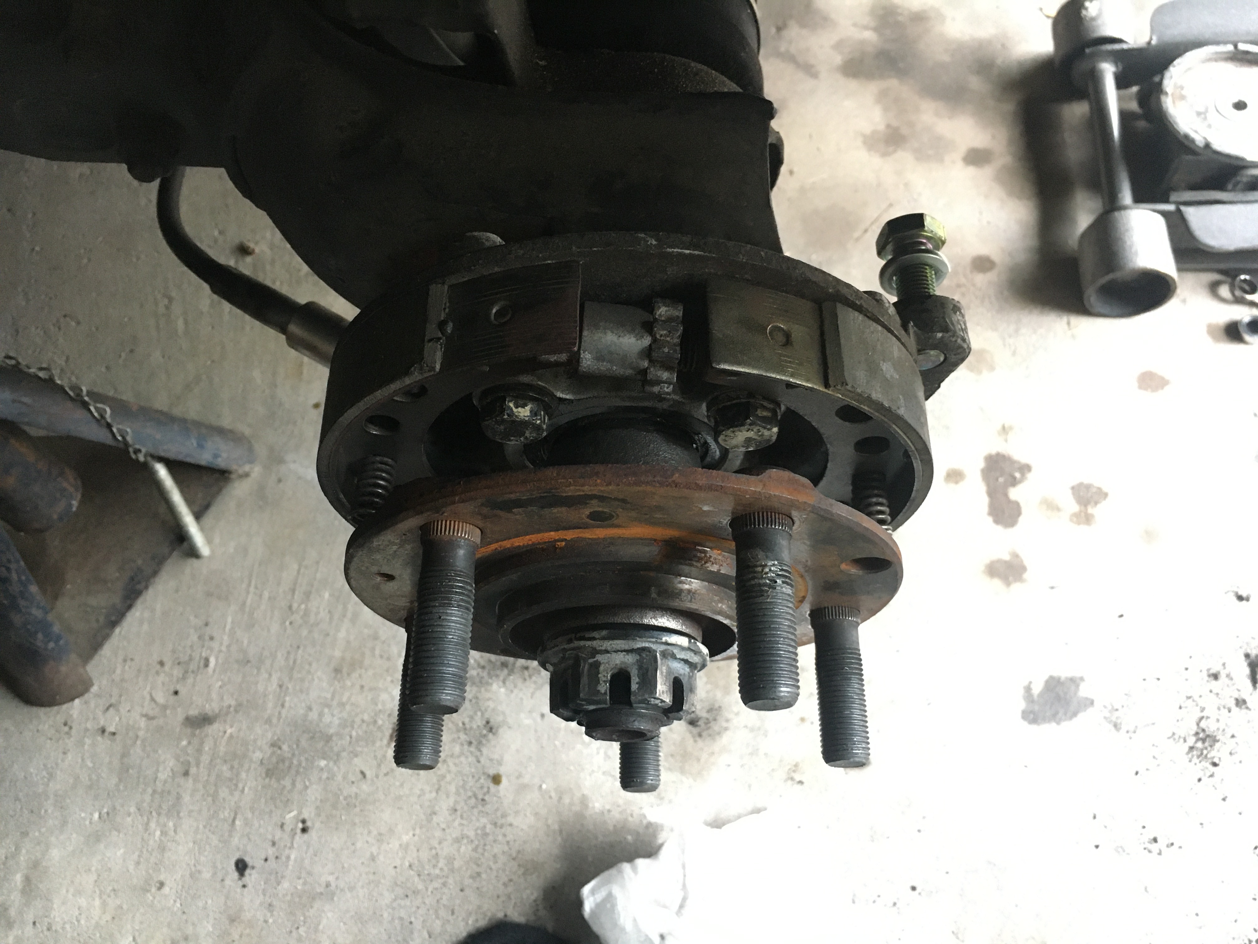

Brakes are all fitted and blead. Pedal is better than my stock ghia disk/drum setup. Parking brake is solid thanks to an adapter to the 944 assembly. I love the simplicity of this parking brake setup compared to the stock drums!
File comment: Parking brake assy.
File comment: Rear hub on.
File comment: Rear complete.

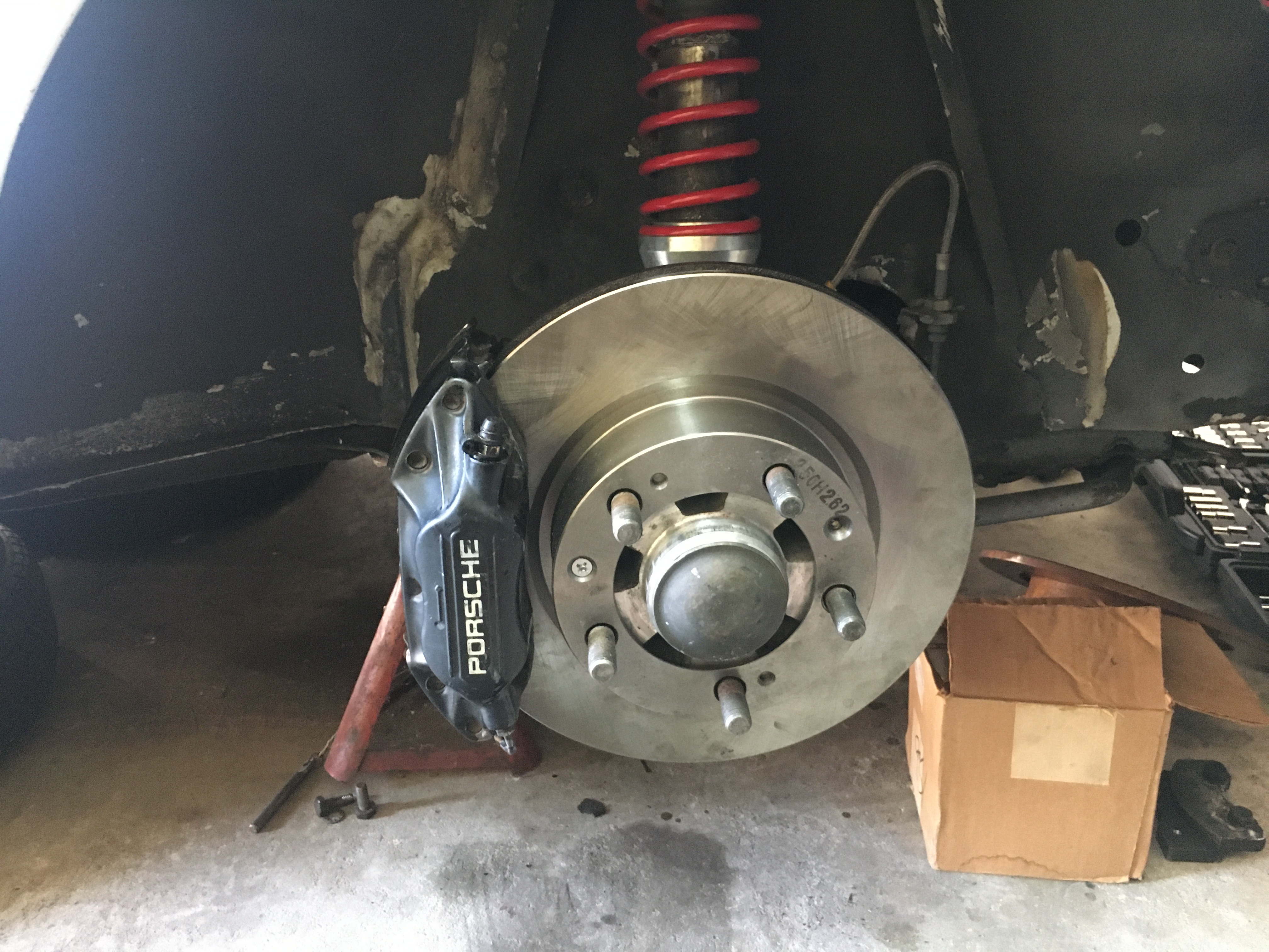

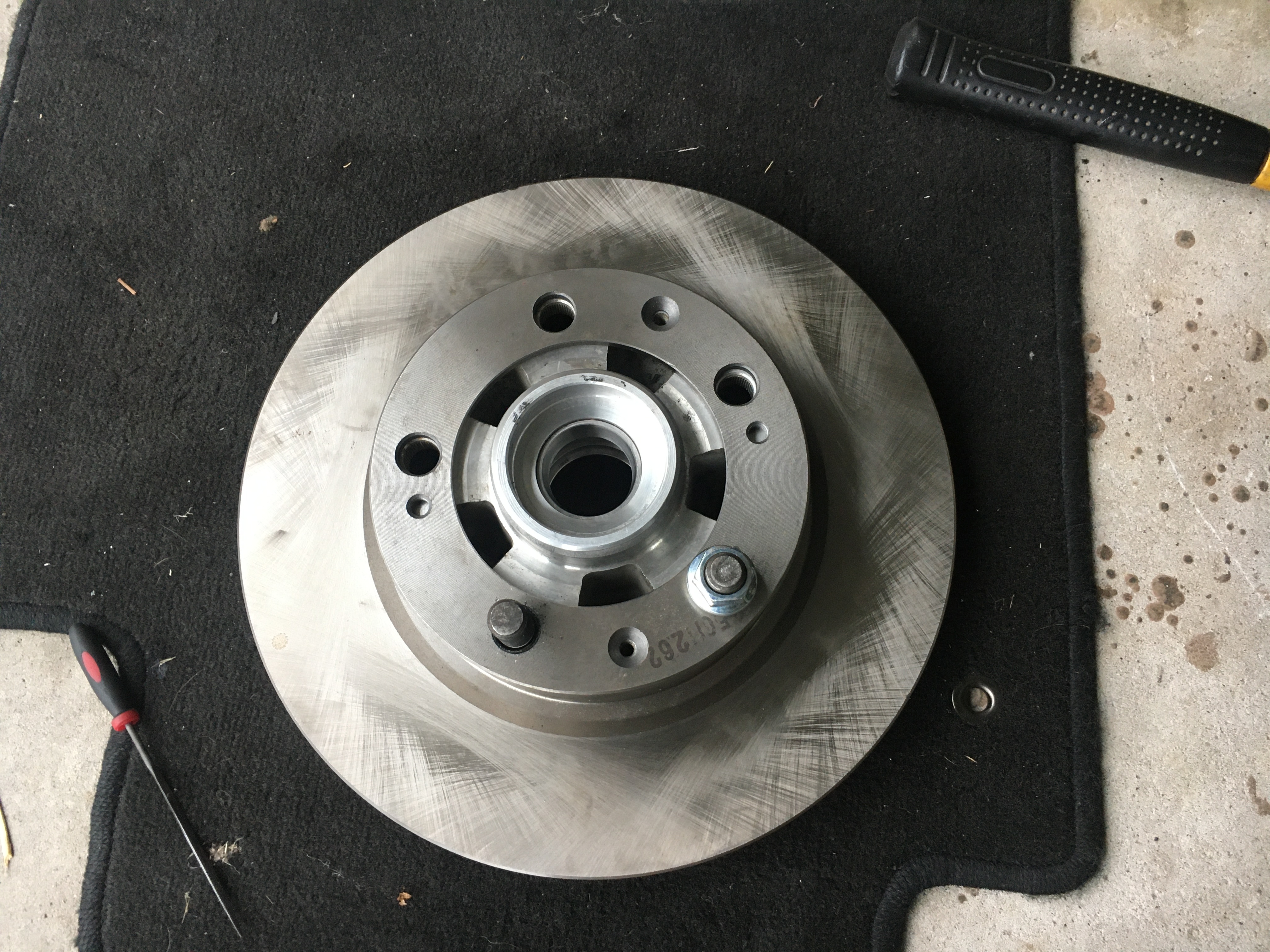

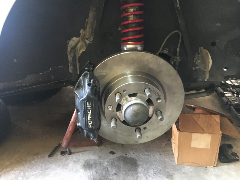

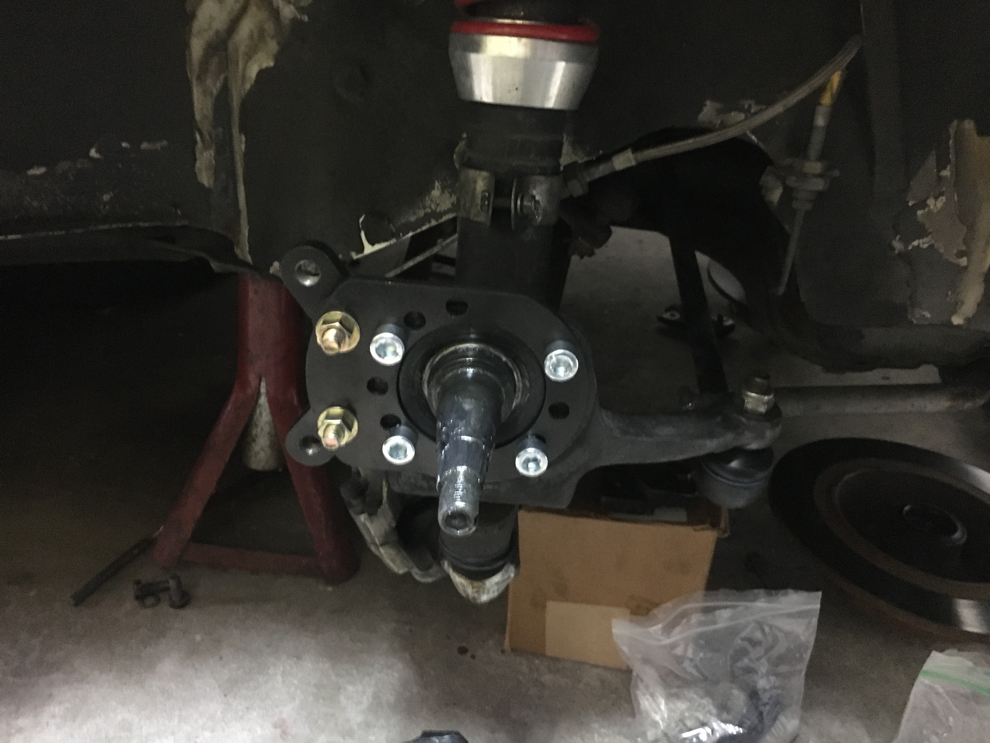

Here's the front setup. Thanks to Ethan Dunlap for help pressing in the studs. :thumbs:
File comment: Front hub and rotor.
File comment: Adapter bracket.
File comment: Front complete.

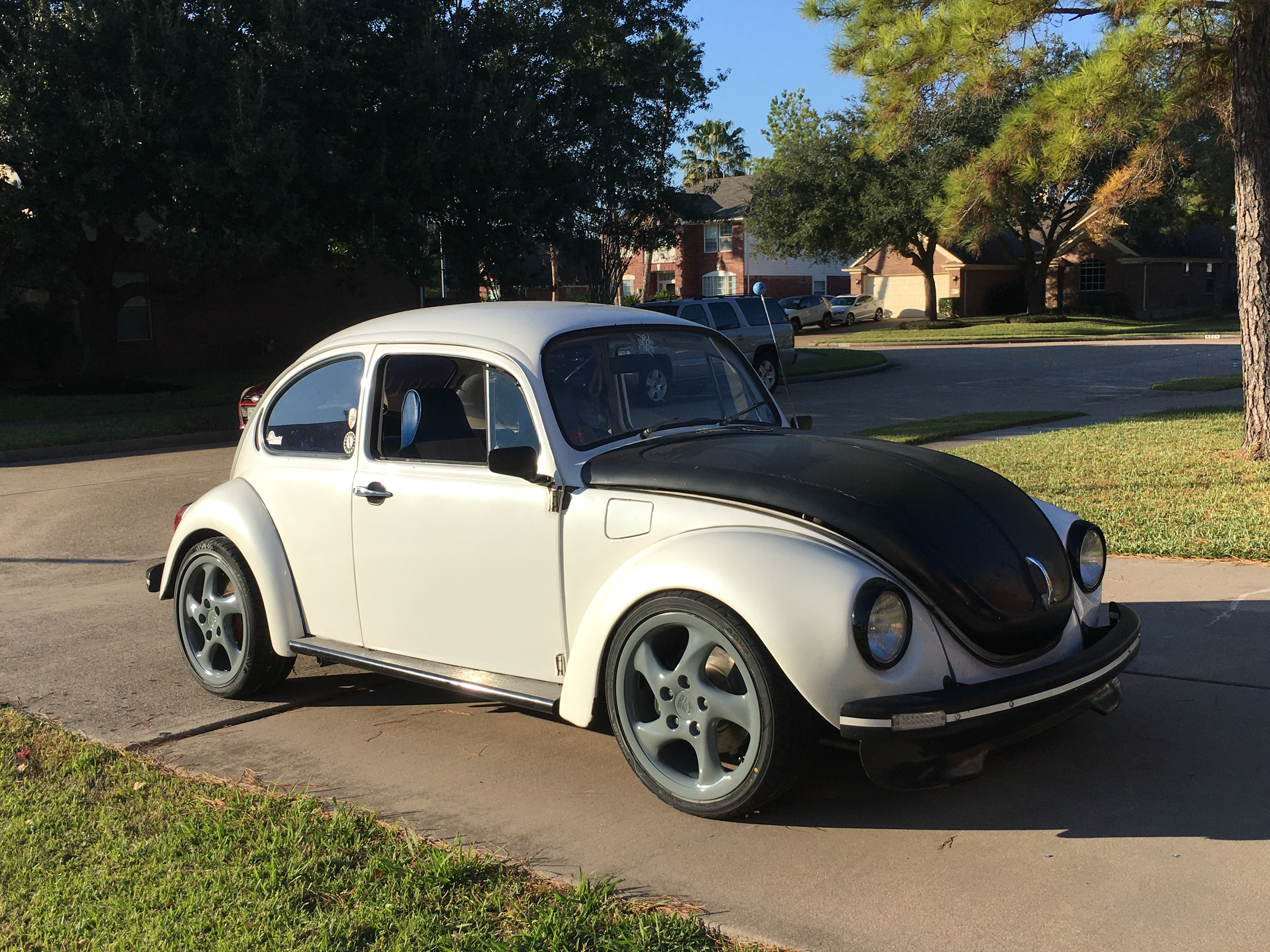

PostPosted: Mon Dec 07, 2020 2:47 pm

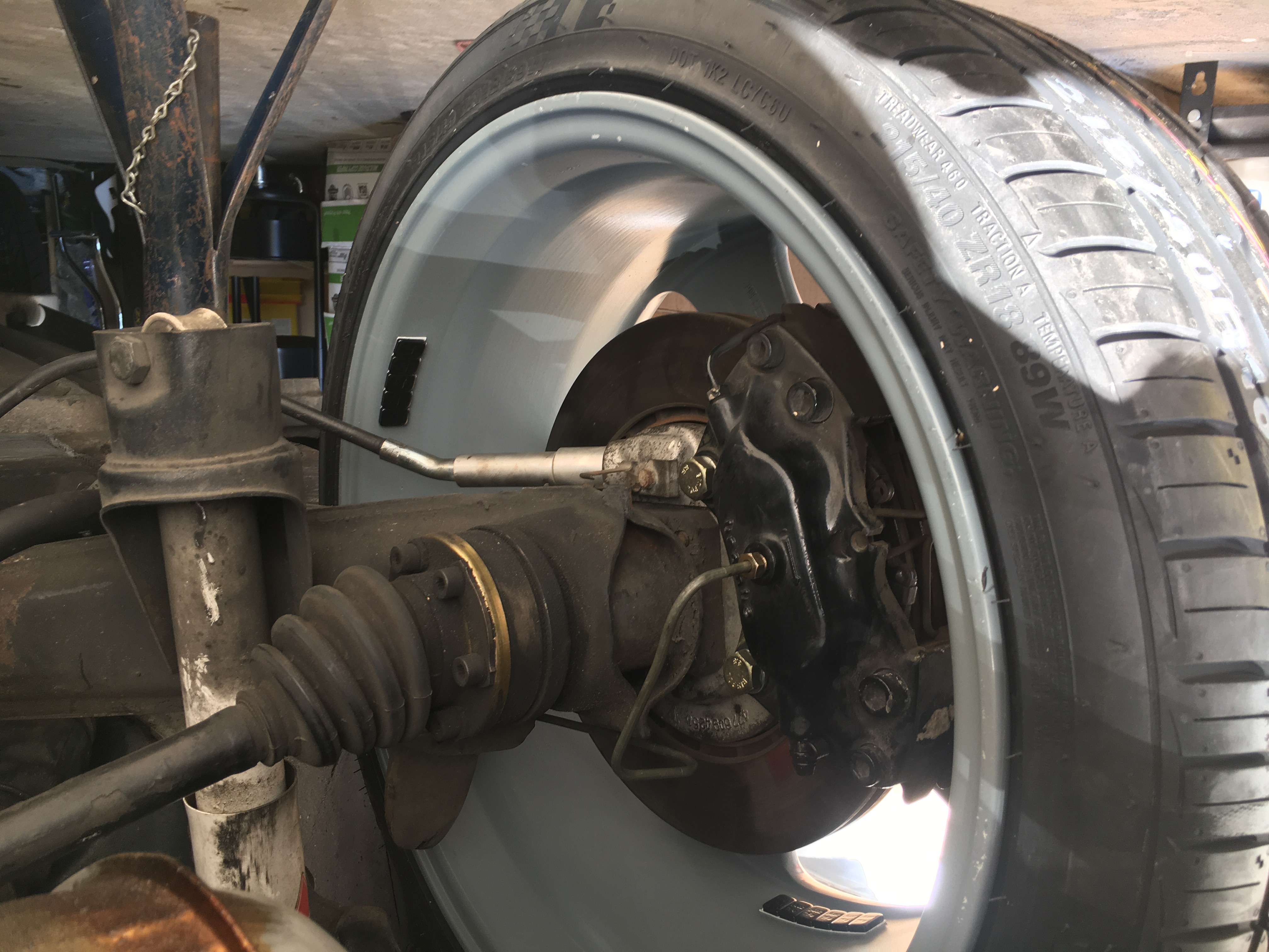

I finally got it off the stands and on the ground to find out that the front tires were rubbing too much... I was afraid of that. I'll have to do some adjusting on the coils, camber bushes and maybe install adjustable strut tops to pull it in a little more. I'm happy with the look though.
