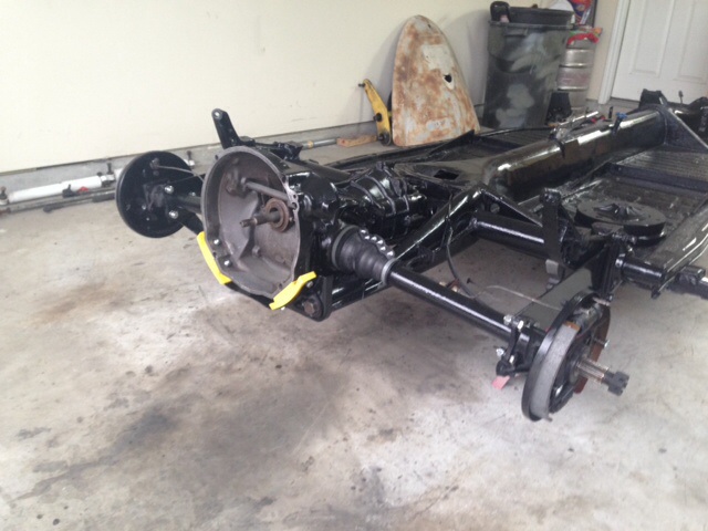

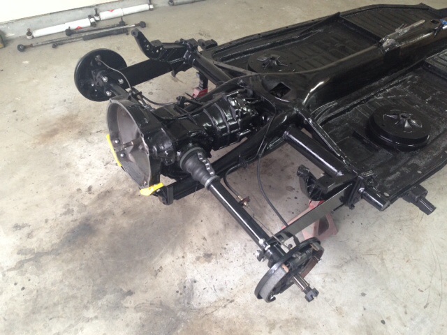

Working on rears. 8-)
 Post subject: Re: Ragtop 59
PostPosted: Sat Dec 14, 2013 7:06 pm
Nice work Red, that's gonna be a clean ride! :thumbs:
PostPosted: Sat Dec 14, 2013 7:56 pm
I agree

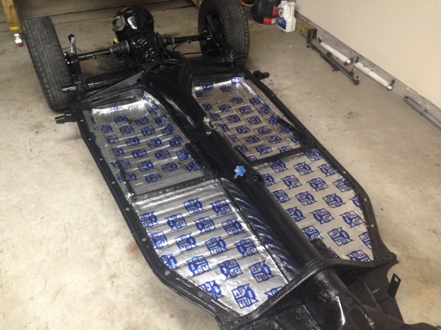

Add Fatmat... 8-)
PostPosted: Thu Dec 19, 2013 9:00 pm
That sure make a difference. Just don't get the urge to hang it on the roof before the headliner. A bunch of people have done it and it always falls off when the car sits in the texas sun. I put it in my oval on the floor pans, on the package tray, a piece in each door and the little area just behind the door. It realy made the car quieter and feel more solid.
PostPosted: Thu Dec 19, 2013 11:17 pm
Yup, had it on my roof for a month. Fell off and had to remove the headliner and take it off. The heat melts it and falls off.
PostPosted: Fri Dec 20, 2013 12:13 am
N8-Car wrote:
I am wondering if there is some installer error. I have used it on every car I have owned and have not had it fall off yet. Even put it on my bus roof and I had it for 14 yrs and it did not fall off. Maybe you guys did not prep the roof properly.
PostPosted: Fri Dec 20, 2013 5:33 am
You might be right, all I did was wipe it down to get the dust off. Probably shoulda cleaned it off a little better. Also, the stuff I used was called Road Blocker or something like that.
