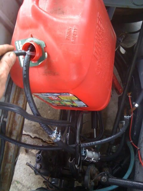

so todays mission was to flush the fuel lines, check the fpr, and hook up my born-again tank.

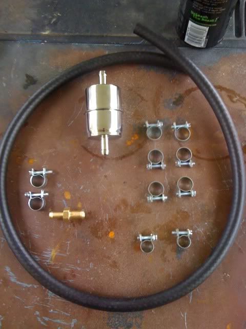

here's all the crap i need for the front of the car:

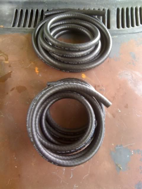

A ish ton of extra fuel line so i can start the motor outside of the car:
My ghetto fab fuel system test rig, I didn't feel like getting a plug for the return fitting on the tank so i just used 2 gas cans. great success, no leaks and good flow.

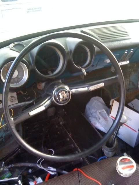

Chuck hooked me up with the correct L41 black steering wheel. I installed it then realized my horn wasn't working. resoldered one wire, everything is working again. Sexiness :beer:

Where do you get those hose clamps?
PostPosted: Mon Mar 14, 2011 7:18 pm
Advanced Auto carries them, $3 for 4. They are ok quality. I got a whole ish-ton of the old school volkswagen hose clamps, now those are friggin nice clamps.

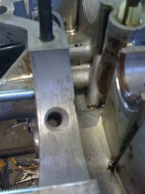

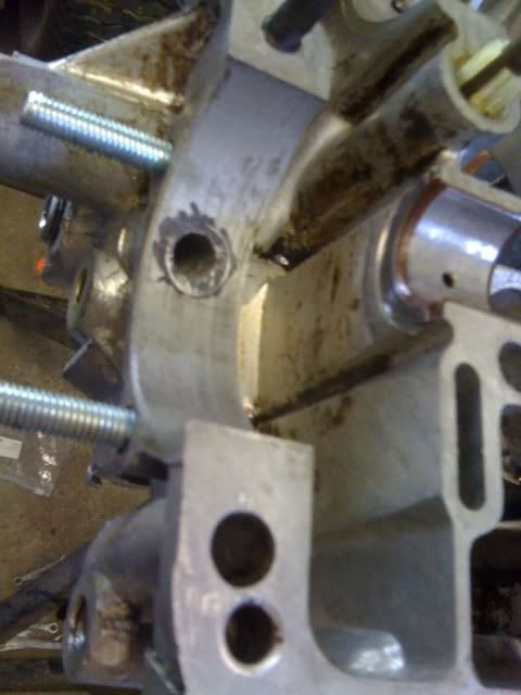

It was brought to my attention that there was a significant miss-match in the diameter of the 30mm pump output and the passage in the case. I didn't even think to check that *facepalm smilie*
so tore the motor back down and scribed the case so I can match port it:
Using a deburring drill bit I proceeded to bore the hole out, smooth transition about 3/4" into the passage as per a recommendation from Tomnotch:
oil flow should be a bit better now since I got rid of that restriction.
