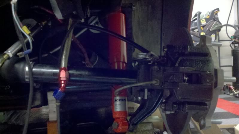

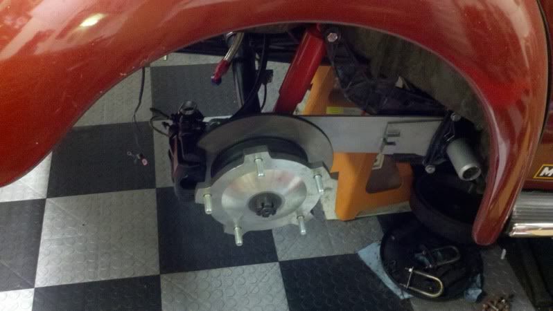

Thanks guys. The only thing with the brakes thats going to take some fussing is the e-brake cables. 55's still have those crazy e-brake cables left over from the mechanical brake days that run all the way to the front of the car. The cables that come with the kit of course are made to attach at the e-brake lever, like 56 and up beetles. I'll fugure something out.
Nick: huge multi-piston brakes are over kill for a 1600 lb car. ;)

Got my Koni adjustable shocks the other day and put them on. Also painted and installed the rear calipers...

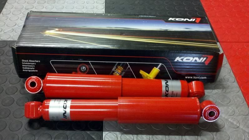

Got Konis for the front too...

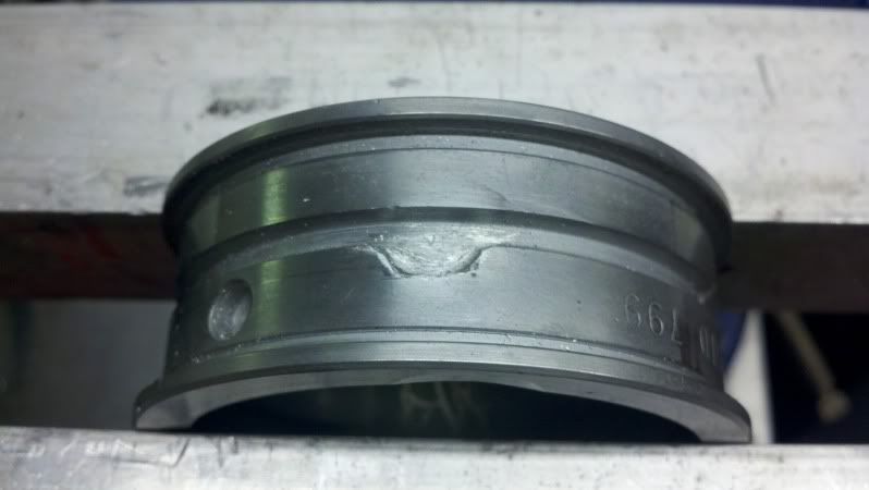

Modified the number 1 and 3 bearings for better oil flow

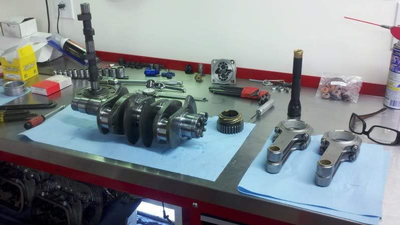

Short block about ready to go together, I just need to put the gears on the crank and hang the rods...

Looks like it wont be long! How do you adjust the shocks?
PostPosted: Mon Apr 23, 2012 10:27 am
When you fully collapse them there is an internal adjustment mechanism that is engaged. You then rotate one end of the shock and it changes the stiffness.
PostPosted: Mon Apr 23, 2012 10:54 am
