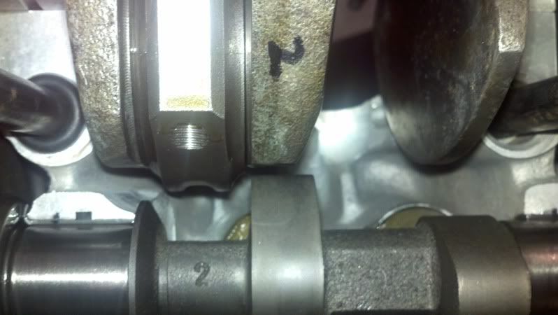

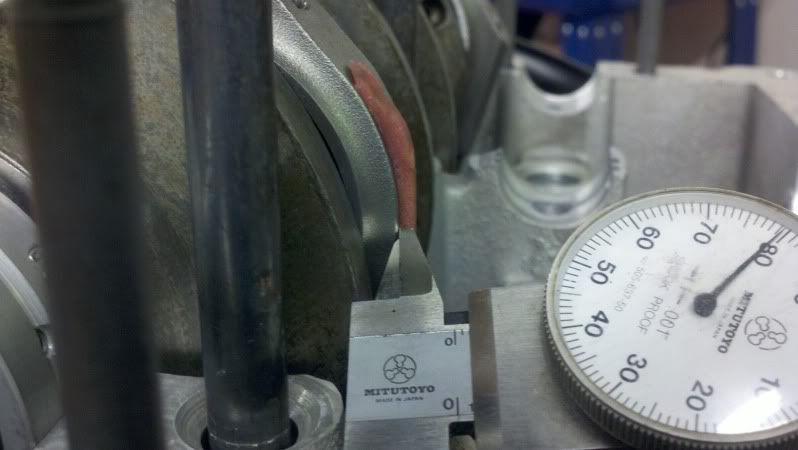

checking clearance between the rods and pistons. And yes, that's Play Dough, lol. There was at least 2 mm, which is plenty.
Clearance between the crank and cam is enough, despite a huge cam and big crank

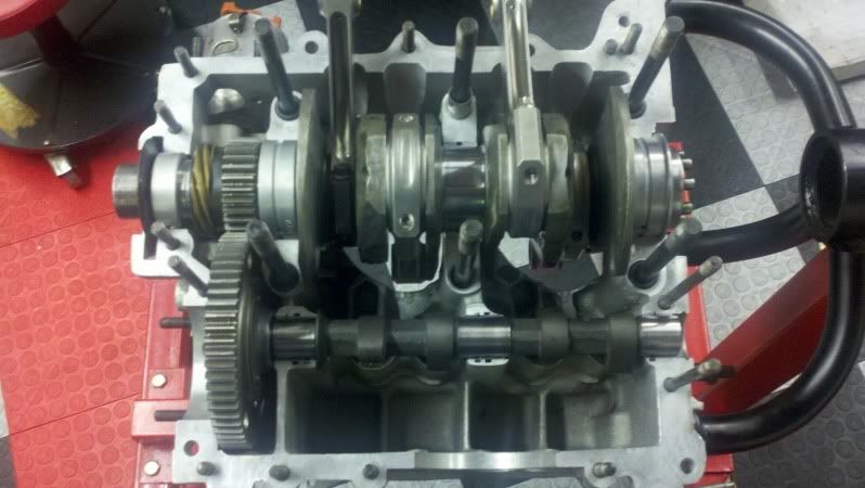

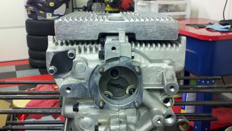

Ready to put together

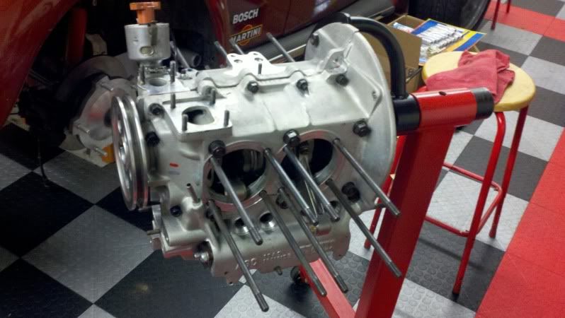

Short block all buttoned up
I got a new sump, its a Scat 1.5 qt. Its about an inch shorter than the EMPI sump I used to run and will give me more ground clearance. I used to bottom out occasionally.

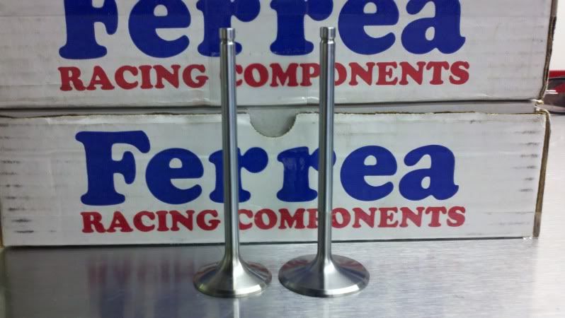

My custom Ferrea valves came in Friday, and I already got my Ti retainers and LS1 springs, so now Darren can build my new heads

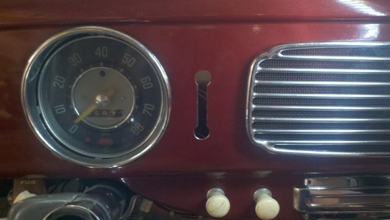

This was just painful, hacking a virgin Oval dash...

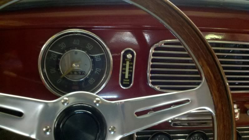

Here's the purpose though...
I'm getting rid of my reserve switch on my tank and putting in an -8 AN outlet to support my new power levels. So its finally time for a fuel gauge.
