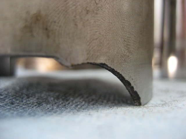

This is the one broken piston. If all else fails, can this be run if the edges are cleaned up?
PostPosted: Fri Feb 06, 2009 1:57 pm
I would think there could be a balance issue ....
PostPosted: Fri Feb 06, 2009 2:04 pm
^^^^^what he said^^^^^
If you could could them to all weigh the same, then I don't think there would be a problem.
PostPosted: Fri Feb 06, 2009 2:25 pm
That Break could be on the lightest one causing it to be even lighter.. meaning you would
have to really take some material off of the heaviest one..
If anything I would try to pickup that set on thesamba .. if just the pistons he said 50 OBO..
ask if he'll do 50 shipped..

you can not run that piston like that you will have to find another piston...dont half ass it you will regret it in the end...pistons are weighted...so much so that they are weighted front to back...i dont know if the break is on the front or the back but either way that would make noise...
