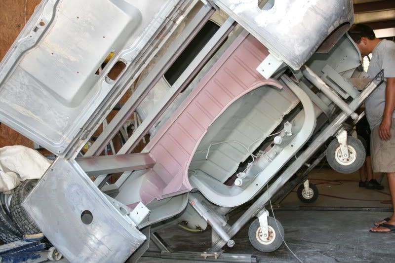

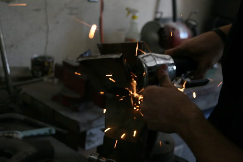

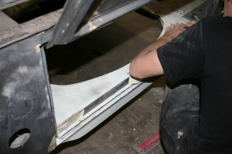

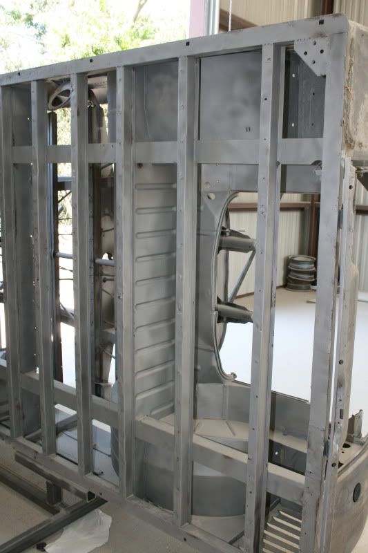

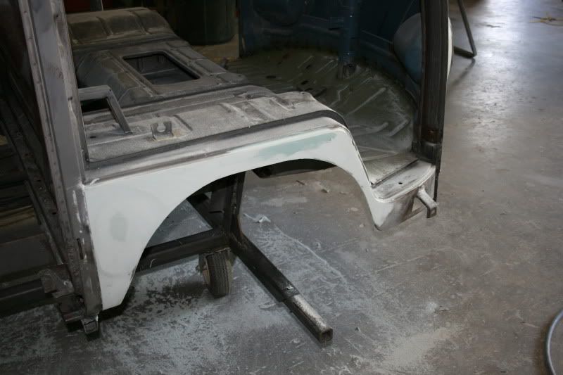

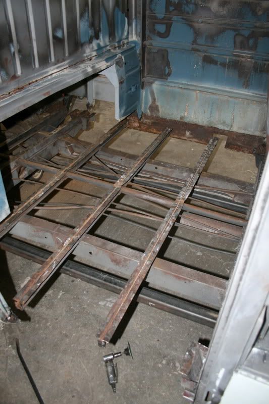

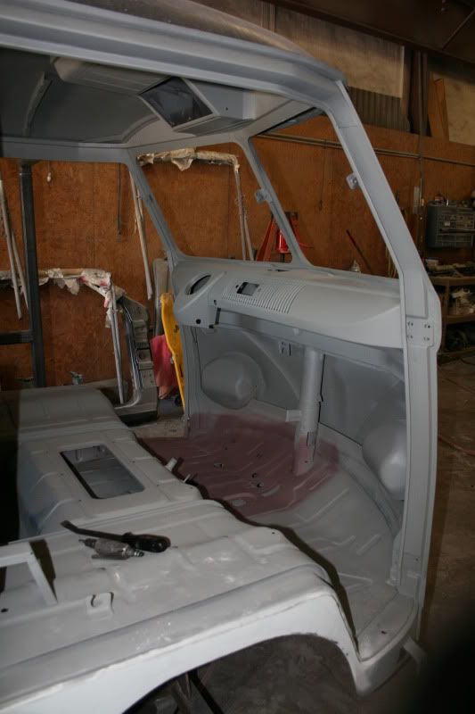

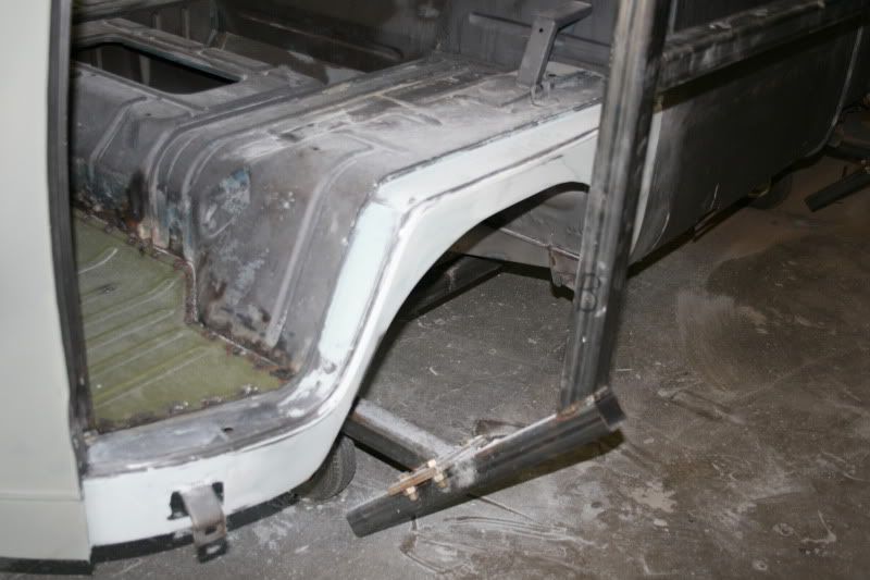

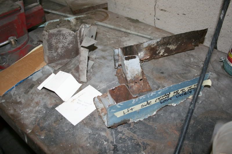

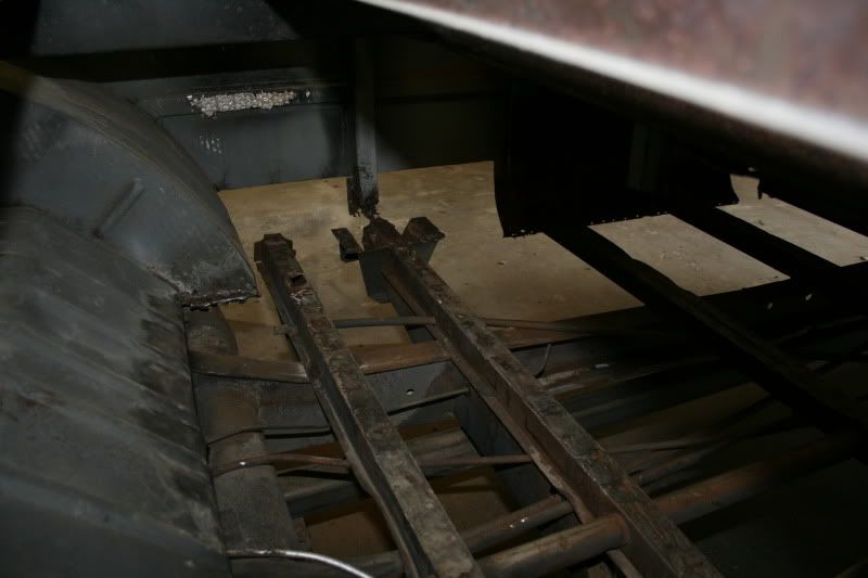

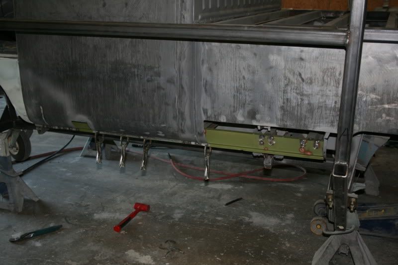

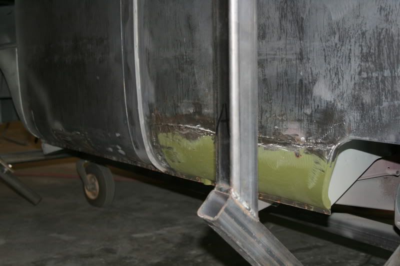

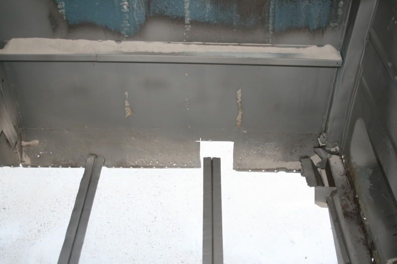

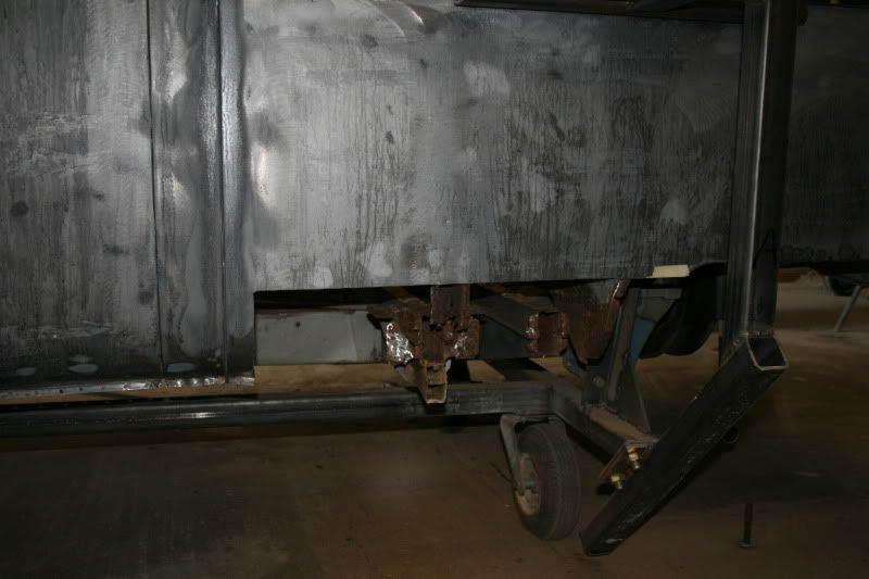

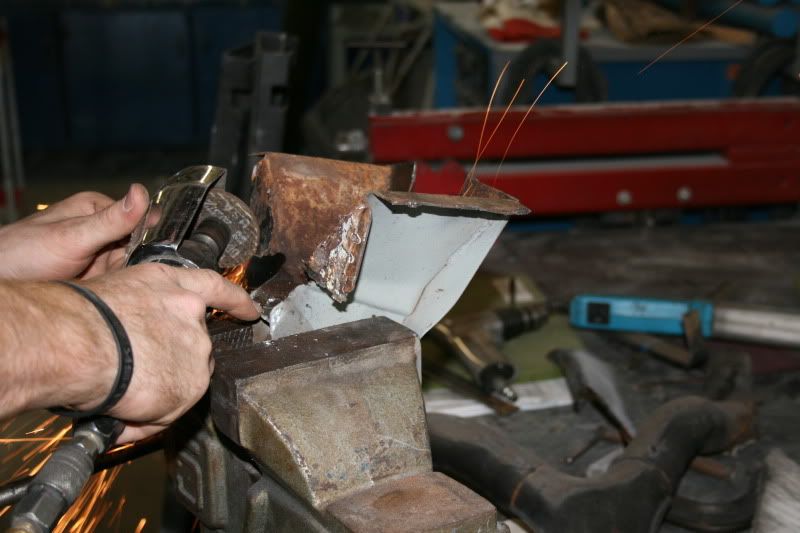

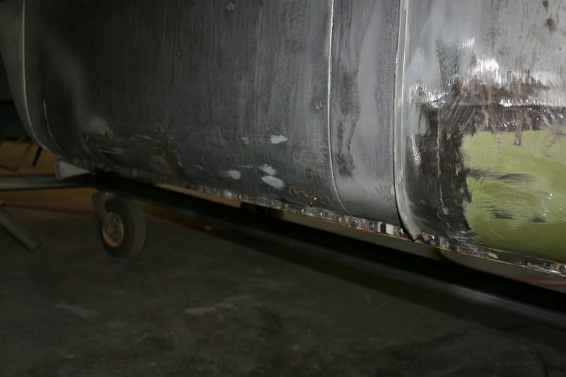

Sorry I haven't updated in awhile, but here goes.... Back from the blaster, and all the braces are cleaned up for the cargo floor. Small braces and other pieces have been cut away and new ones prefabbed to go in with the floor. Allot of cutting and grinding has been going on. At this point the inner rockers are in and the cargo floor should be in by Friday.

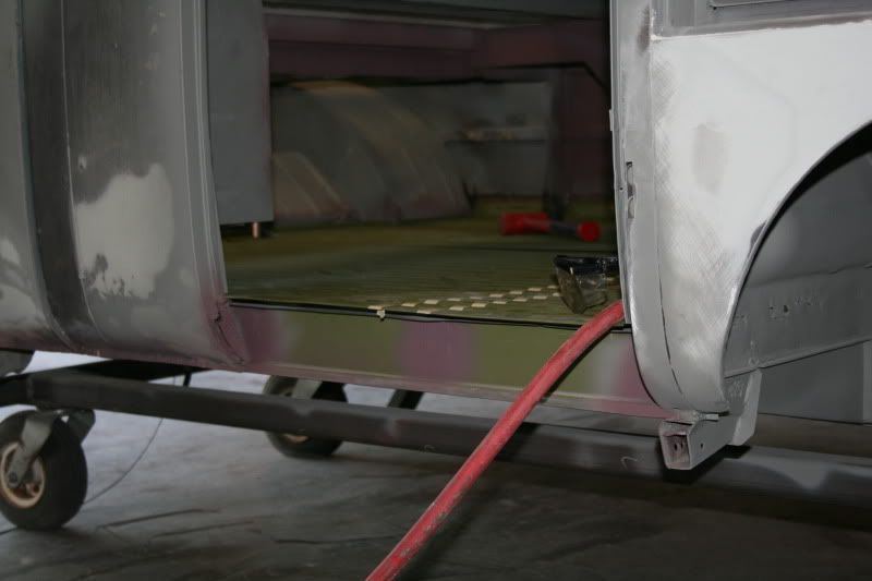

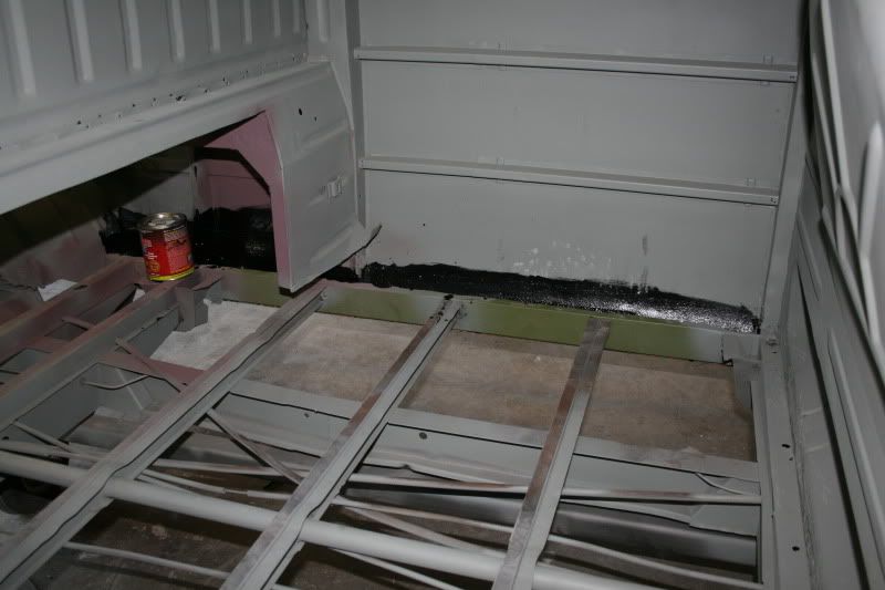

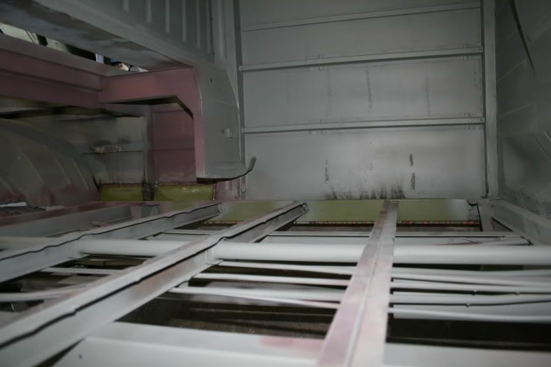

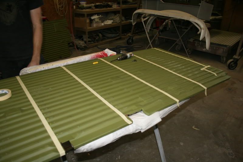

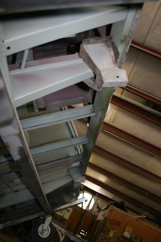

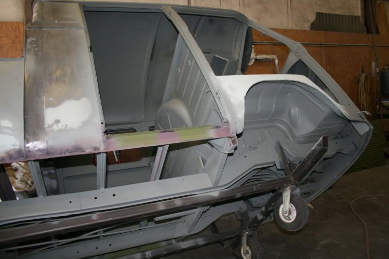

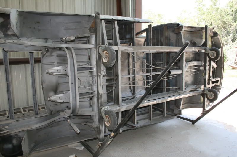

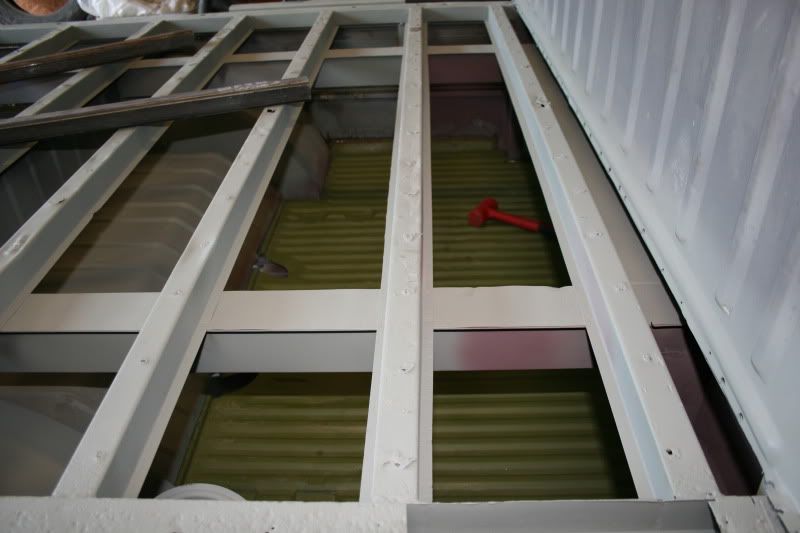

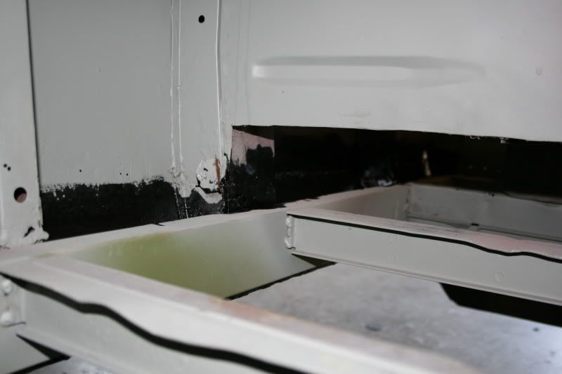

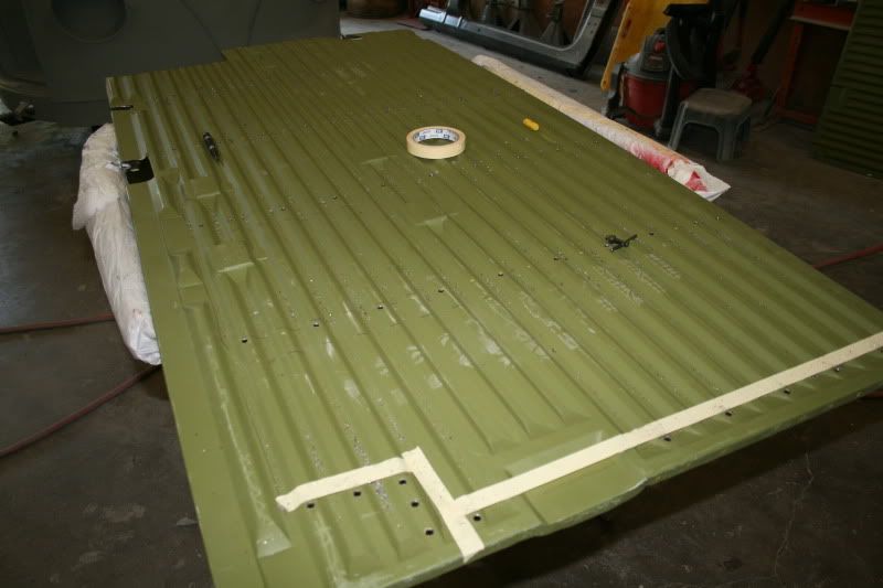

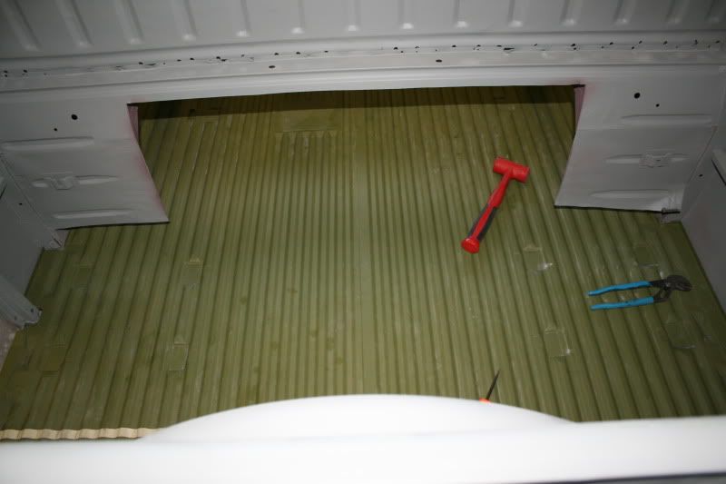

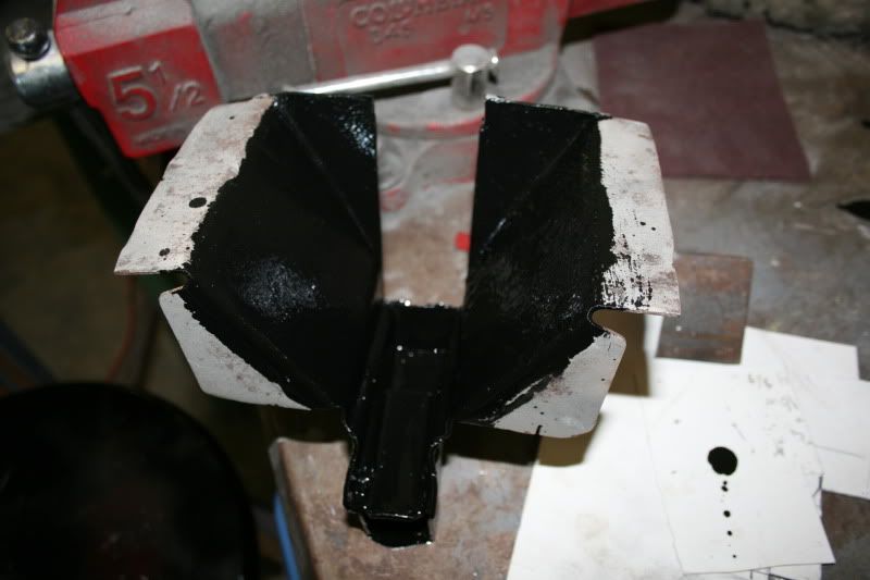

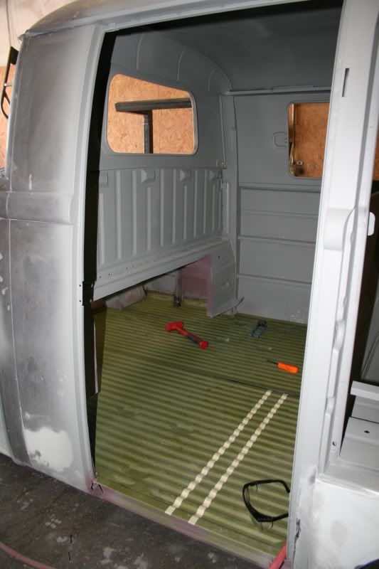

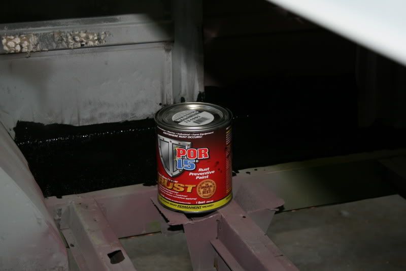

We didn't get the cargo floor welded in today, but it's test fitted and ready to be welded Monday morning. The heat, and a piece of crap Ford Sport Trac held us up some. The DC is now completely rust free :dance: Matt and I worked real hard cutting, grinding, and welding. The patch panels are in, and the lower rockers are welded to the inner rockers now. Holes are just about all drilled for the spot welds on the floor. Por 15 was brushed on the inner panel bottoms where it is prone to rust. Epoxy primer is now on all the inside and underside, including the floor frame sections. So it shouldn't ever rust again.
