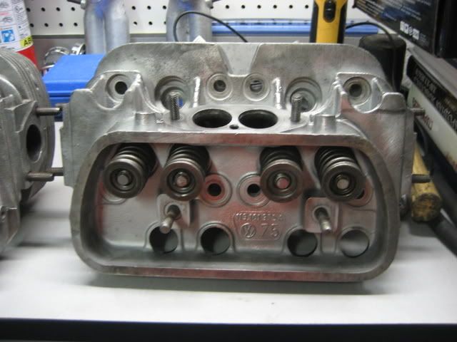

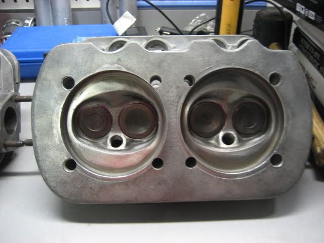

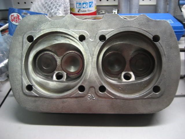

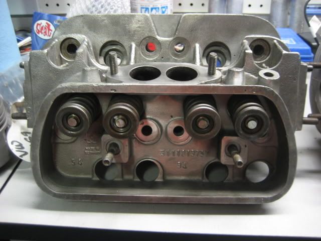

Well, the heads are now back from the machine shop (Davids Machine), and I got a set of used pistons that match the ones the motor came with, so we're back on track. Also have a set of new Scat single hi-rev springs to go on the heads too. Here are some pictures!
